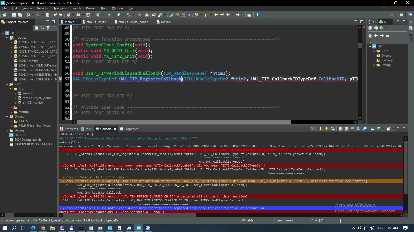

can someone help me ? I do not know how to use "HAL_TIM_RegisterCallback" function.
My unsuccessful trial is in attachments. Can someone correct it ?  + to attach the corrected version ?
I tried this example:  https://deepbluembedded.com/stm32-timer-interrupt-hal-example-timer-mode-lab/
and it is working ok, but this example:
https://community.st.com/t5/stm32-mcus/how-to-use-register-callbacks-in-stm32/ta-p/580499
is not working - see screenshot below. .
AScha.3
AScha.3Best answer
Feb 14, 2025 6:50 PM UTC
did you enable the callbacks, you want to use ? (in Cube -> project settings)
read
read
JerryMC22Author
Feb 14, 2025 8:19 PM UTC
Wou, it is working. Thanks.
