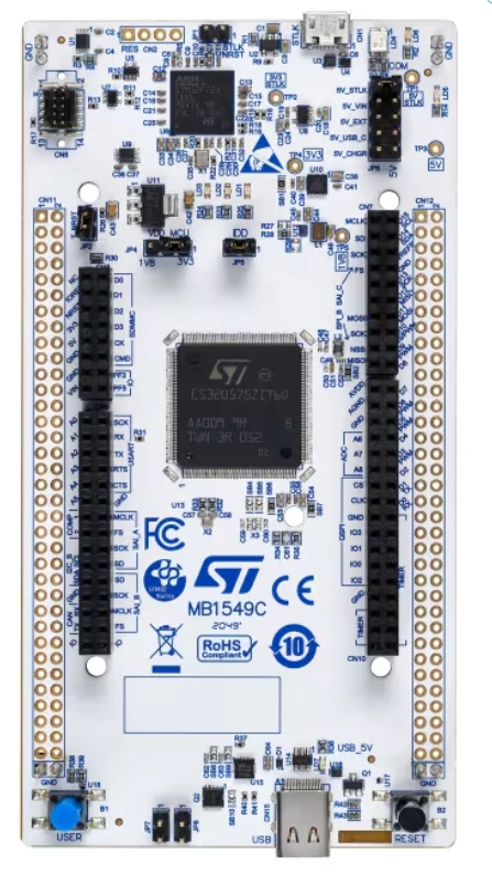

Hello STM team,
We are working to interface the  NUCLEO-U5A5ZJ-Q and nRF7002-DK using QSPI. We are using vanillas zephyr. We are able to built the code for SPI. But can not be able to built for QSPI. It will be very helpful if you provide a proper support to interface this.
19 replies

I want to use QSPI protocol. For that I have added the overlay file to configure the QSPI pins of the NucleoU5A5ZJ (Overlay file is attached already). In overlay file the nRF7002 accepts the SPI, QSPI or Coaxe instance. And NucleoU5A5ZJ is having OctoSPI.

Problem statement: Need to know how can we connect the OctoSPI with the nRF7002 in the overlay file. We tried to use OctoSPI instance with nRF7002, but it throughs error when built.
nRF accept SPI, QSPI or Coaxe instance only.
While NucleoU5A5ZJ supports SPI and OctoSPI.

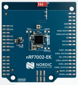

I have ordered the nRF7002-EK already. Once I receive that board I can test on it. This is just to get start with existing hardware available with me.
April 23, 2026
I have a update in this project.
I received the nRF7002-EK board. I make the all necessary connection between NucleoU5A5ZJ-Q and nRF7002-EK.
I test the shell code working on SPI interface and that get worked.
So now, I am able to operate the nRF7002 using STM32 board using SPI protocol. I am able to scan the available wifi and also get connected to one of it. This is working fine.
So now coming to a same page, My hardware setup is tested and working fine for SPI interface.
Now, I just need to figure out how to port the shell example code to work on QSPI.
nRF7002-EK: https://www.nordicsemi.com/Products/Development-hardware/nRF7002-EK
NucleoU5A5ZJ-Q: https://www.st.com/en/evaluation-tools/nucleo-u5a5zj-q.html

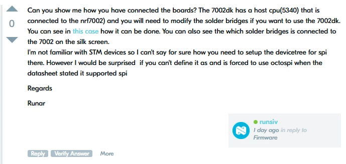

I have already ask with Nordic team. But they are taking time to reply back. And also not helping me to solve the problem. I don't know if they support the other host MCU to get work with nRF7002 via QSPI ?image.png
Yes, I require to work on QSPI instead of SPI protocol. As QSPI is more faster compared to SPI. Our application requires speed.
