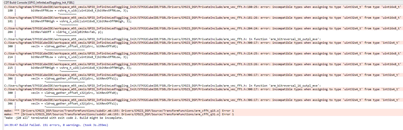

I am setting up my first m55 STM32 project using the NUCLEO-N657X0 dev board with the CMSIS DSP libraries. I have copied the CMSIS DSP libraries into my project and I have added the CMSIS-DSP include paths into my project, but I am receiving the following build error message,
arm_vec_fft.h: error: incompatible types when assigning to type 'uint32x4_t' from type 'int32x4_t'
Can you please provide a recommendation to resolve this error?

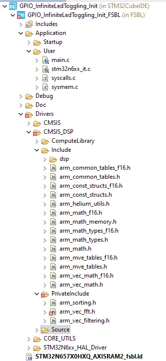

Hello @kag_embedded ;
I think you have an issue with multiple definitions, in this case you need to go through every folder in Drivers/CMSIS_DSP/Source and comment out every #include "file.c" in "folder name.c" and "folder nameF16.c"file.
An example to support SupportFunctions is shared in this FAQ step 8.
Please look at this example and apply this solution to all folders in source.

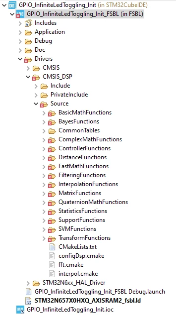

I believe I have followed the instructions per the link provided. My project will be using additional CMSIS-DSP library calls, so I have included them as well in CMSIS_DSP/Source.
I have successfully used CMSIS-DSP in my STM32 projects for the m0+, m4, m33, and m7 cores. This issue arose when I tried to build my first CMSIS-DSP libraries for the m55 with Helium vector support.
Is there an example of using the CMSIS-DSP with a Helium supported core?

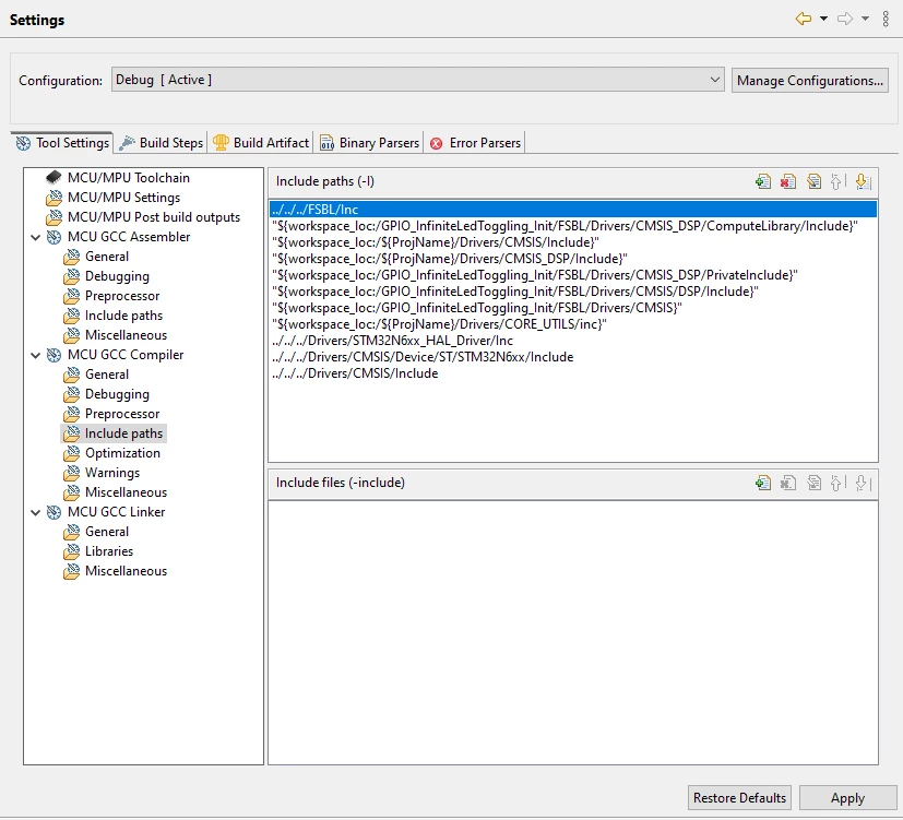

Hello @kag_embedded;
Make sure that you’re added the following flag -flax-vector-conversions in Project →  Properties →  C/C++ Build →  Settings →  MCU/MPU GCC Compiler →  Miscellaneous →  "Other flags" as mentioned here.

May 28, 2025 10:25 PM UTC
@KDJEM.1 Thank you for the recommendation of the -flax-vector-conversion flag. It has enabled me to get further into the project build process, but I am still having errors in the build of the CMSIS functions. It appears that the .c files are being built twice, and during the second build, it fails due to "multiple definitions." I have not had this issue on my previous CMSIS projects using m0+, m4, or m33. The path for both definitions appear to be identical.
Can you please recommendation a solution? Thank you.

May 30, 2025 1:04 AM UTC
Thank you. Each of the folders had two .c files that #included all the other .c files. After deleting these files from the folder, I was able to build the CMSIS library.
