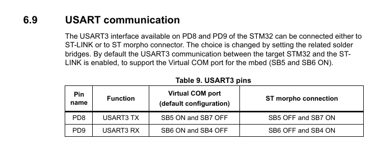

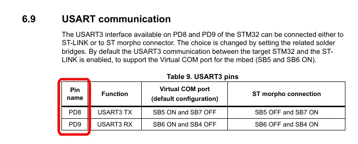

The VCP is connected to pins PD8 (UART TX output) and PD9 (UART RX input):
You won't get anything through the VCP unless you use those pins!

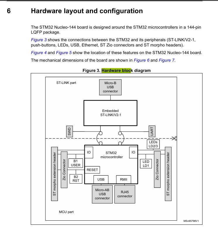

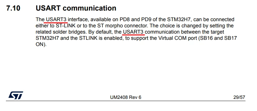

Andrew Neil
Jun 25, 2025 9:53 AM UTC
@Andrew Neil wrote:
How is it connected to USART2 of your STM32 ?
@KRISH_  If you're expecting to use the Virtual COM Port (VCP) in the ST-Link, that is connected to USART3 - not USART2:
https://www.st.com/resource/en/user_manual/um2408-stm32h7-nucleo144-boards-mb1363-stmicroelectronics.pdf#page=29
via: https://www.st.com/en/evaluation-tools/nucleo-h7a3zi-q.html#documentation
KRISH_Author
Jun 25, 2025 11:16 AM UTC
Merged - please keep the discussion in one place.

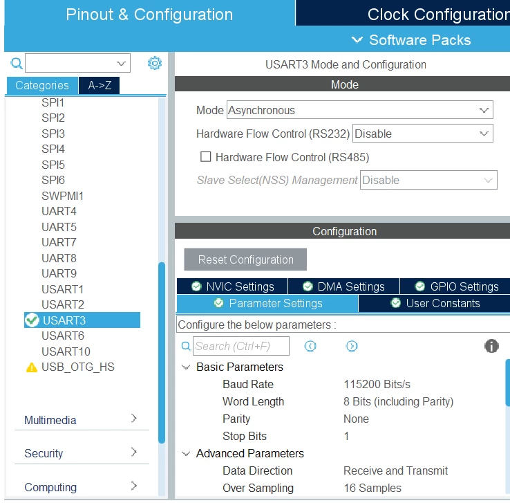

I checked the User manual, it said USART3 .But still I wasn't able to enter anything in the serial console.1.png2.png
KRISH_Author
Jun 25, 2025 11:21 AM UTC
You're right. I tried with
USART3, and I am still unable to enter anything in the serial console.

So you are trying to go via the ST-Link's VCP, then?
Were you misled by the tutorial into using UART2?
How are you testing that?
Are you sure that your board hasn't been reconfigured?
Are you using the correct pins?
Are you sure your console is connected to the correct COM port?
Can you just send from the STM32 to the console?
Again, please show the complete code.

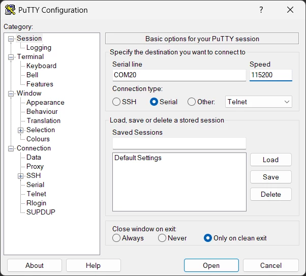

KRISH_Author
Jun 25, 2025 2:26 PM UTC
Using Putty (serial connection), i am testing whether I can enter characters to the terminal. I believe the characters I enter should be visible to me. It is not just about HAL_UART_Receive, I can't see the transmitted data either with sprintf().
The pins shown in the user manual are PD8 and PD9, but by default, the assigned pins are PB10 and PB11.In the NVIC settings I have enabled USART3 as global interrupt.
I have chosen the correct COM port, which is COM20 (I double checked using the device manager). I do not know whether the data I am sending via USART is reaching the MCU. But the printf() statements do get displayed on the serial monitor. Screenshot 2025-06-25 194826.png

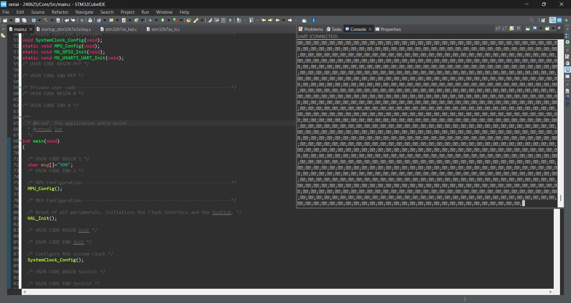

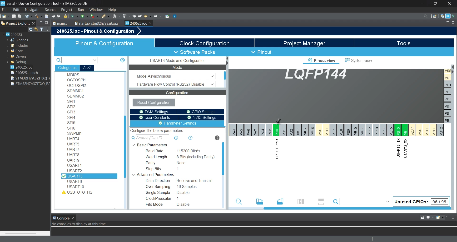

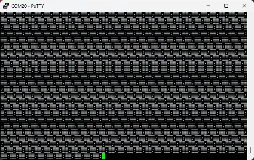

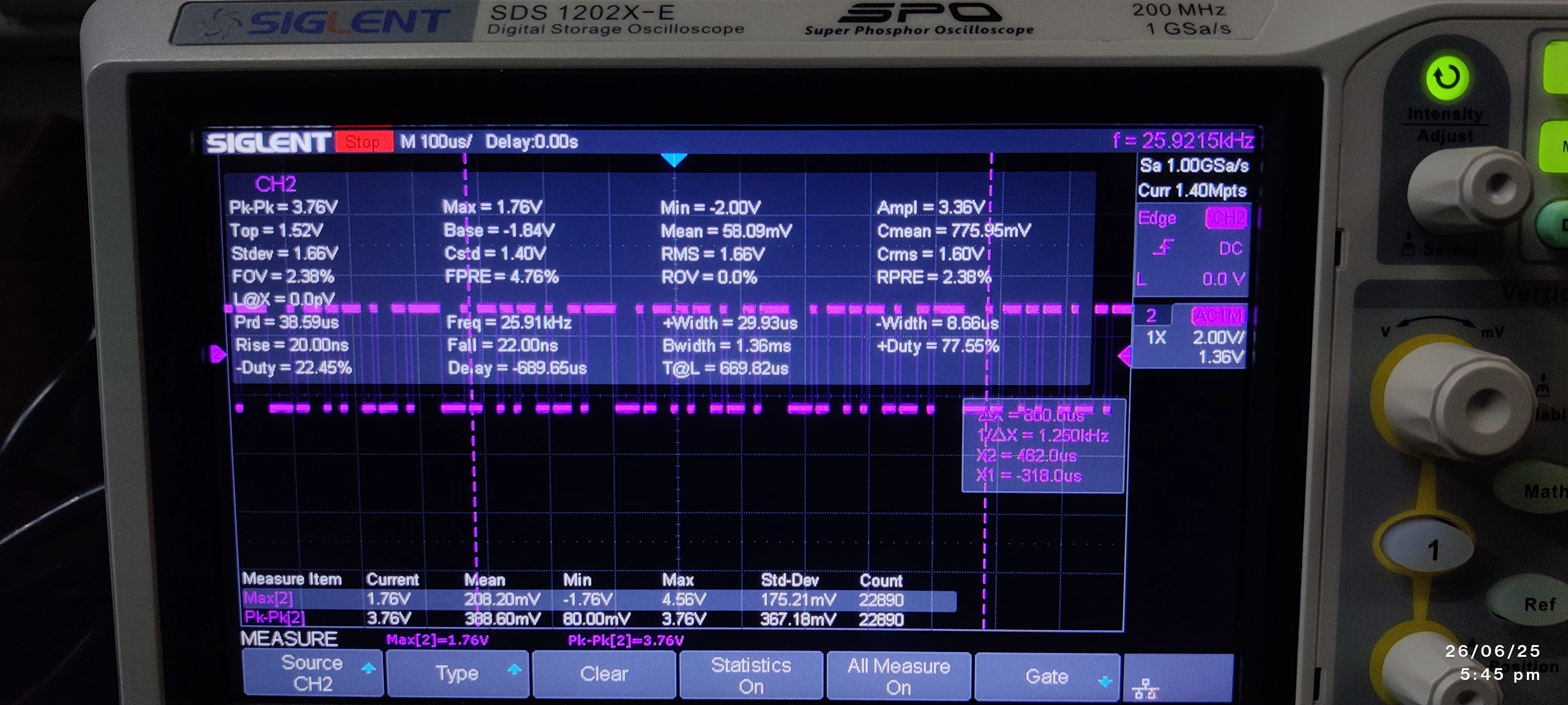

KRISH_Author
Jun 26, 2025 1:07 PM UTC
I assigned pD8 and pD9 as usart3_TX and usart3_RX in the GUI and soldered pins on the board's pD8 and pD9 pins.
I got signal from PD8  and also  got some characters printed in my serial monitor in the CUBEIDE but they aren't the desired characters.IMG_20250626_174530.jpg
Andrew Neil
Jun 26, 2025 1:46 PM UTC
Please see your scope manual for how to properly capture screenshots - this will give much better results than photographing the screen!
It looks like it should be able to do serial data decoding:
https://siglent.co.uk/product/siglent-sds1202x-e-2ch-200mhz-1gsa-s-super-phosphor-oscilloscope/#:~:text=Serial%20decoding%20is%20free%20and%20includes%20IIC%2C%20SPI%2C%20UART%2C
You shouldn't need to solder anything - this should be the default.
"Garbage" characters like that generally mean you have the baud rate wrong:
https://learn.sparkfun.com/tutorials/serial-communication/all#:~:text=If%20all%20the%20receiving%20device%20sees%20on%20its%20receive%20line%20is%20garbage%2C%20check%20to%20make%20sure%20the%20baud%20rates%20match%20up
KRISH_Author
Jun 26, 2025 3:01 PM UTC
Thanks a lot for the advice on the oscilloscope, it was very helpful.
Sorry for asking again . But the baudrate of USART3 and putty seems to be the same 115200 and still getting the garbage characters
the usart3 set to 115200the usart3 set to 115200putty serial set to 115200putty serial set to 115200Screenshot 2025-06-26 202055.png
KRISH_Author
Jun 26, 2025 1:08 PM UTC
