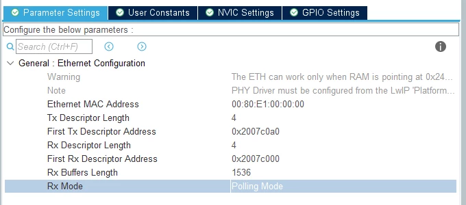

ETH Configuration:

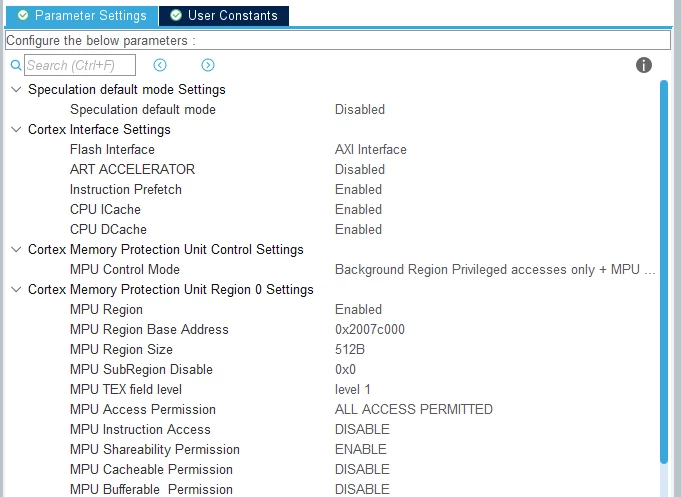

MPU Config:

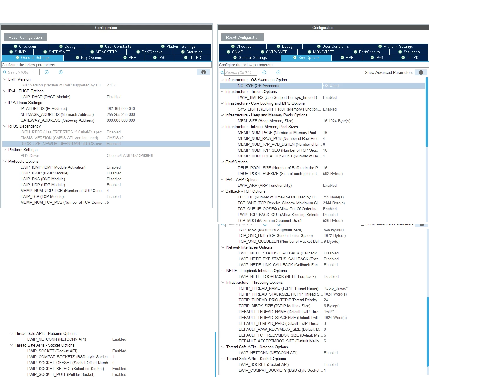

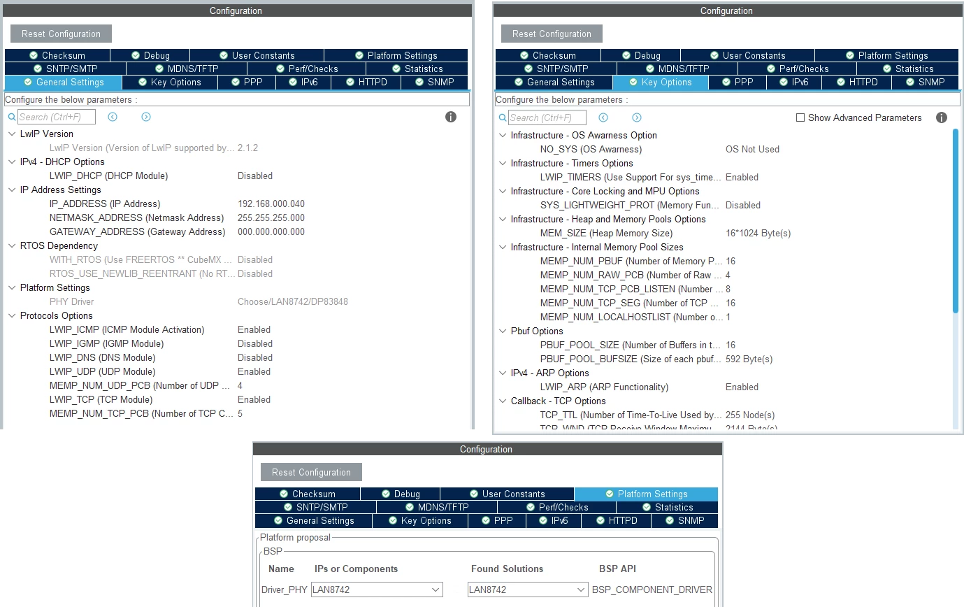

lwIP Config:

ETH Changes:
RX Mode: Interrupt Mode

lwIP some of the settings changed, it enabled OS-Mode for lwIP. (I haven't actively changed any):
WITH_RTOS (Use FREERTOS ** CubeMX specific **): Enabled
CMSIS_VERSION (CMSIS API Version used): CMSIS v2
RTOS_USE_NEWLIB_REENTRANT (RTOS used - 1): Enabled
NO_SYS (OS Awarness): OS Used

In the No-OS Mode I call ethernetif_input(...) and sys_checks_timeouts() which calls the lwip-stack. However, with FreeRTOS implementation I don't do this, but it is my understanding looking in the code that it should create a lwip task that handles the stack so I think I shouldn't need to call anything to get it working with ping?
