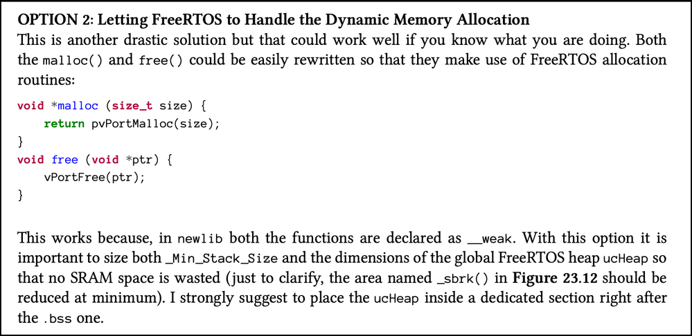

I saw another approach to this issue in the book "Mastering STM32 - Second Edition" (page 616), which replaces all newlib malloc/free calls with the FreeRTOS-managed functions, so that all dynamic memory comes from the FreeRTOS heap:
This seems like a clean approach that modifies existing projects minimally. Perhaps there are some downsides to this method that I'm not aware of? It seems that pvPortMalloc can be used before the FreeRTOS scheduler starts, so early malloc calls wouldn't be a problem I assume?
