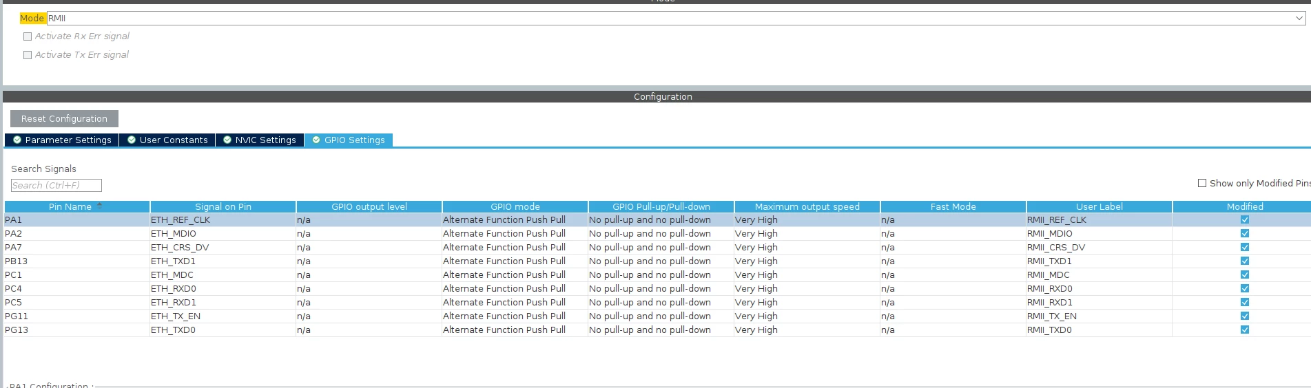

Hello Folks,
[Re-posting this question since I believe I had it in the from Board. I would delete the original one if I could.]

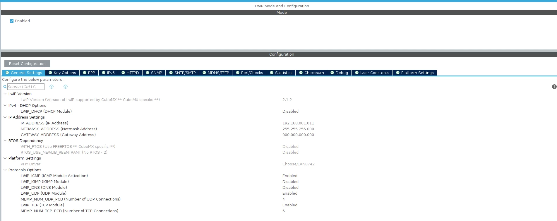

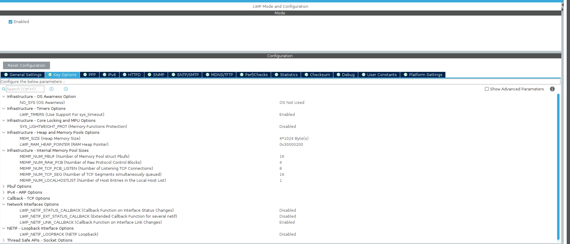

I use the H723ZG Nucleo board without FreeRTOS. I had configured Ethernet for the H723ZG in the past. But I am unable to configure it again now, even when following the same steps. When I first got it working, my configuration was based on this Youtube video STM32 ETHERNET #1. Hardware Configuration || PART 1.
In addition, I spent countless days trying to configure the Ethernet without FreeRTOS based on this post How to create project for STM32H7 with Ethernet and LwIP stack working from @Adam BERLINGER . I was able to get it working WITH FreeRTOS, but not WITHOUT it. And I am here to kindly ask for your help.
Here are some screenshots from my `.ioc` file.
I am testing it with the ping example.

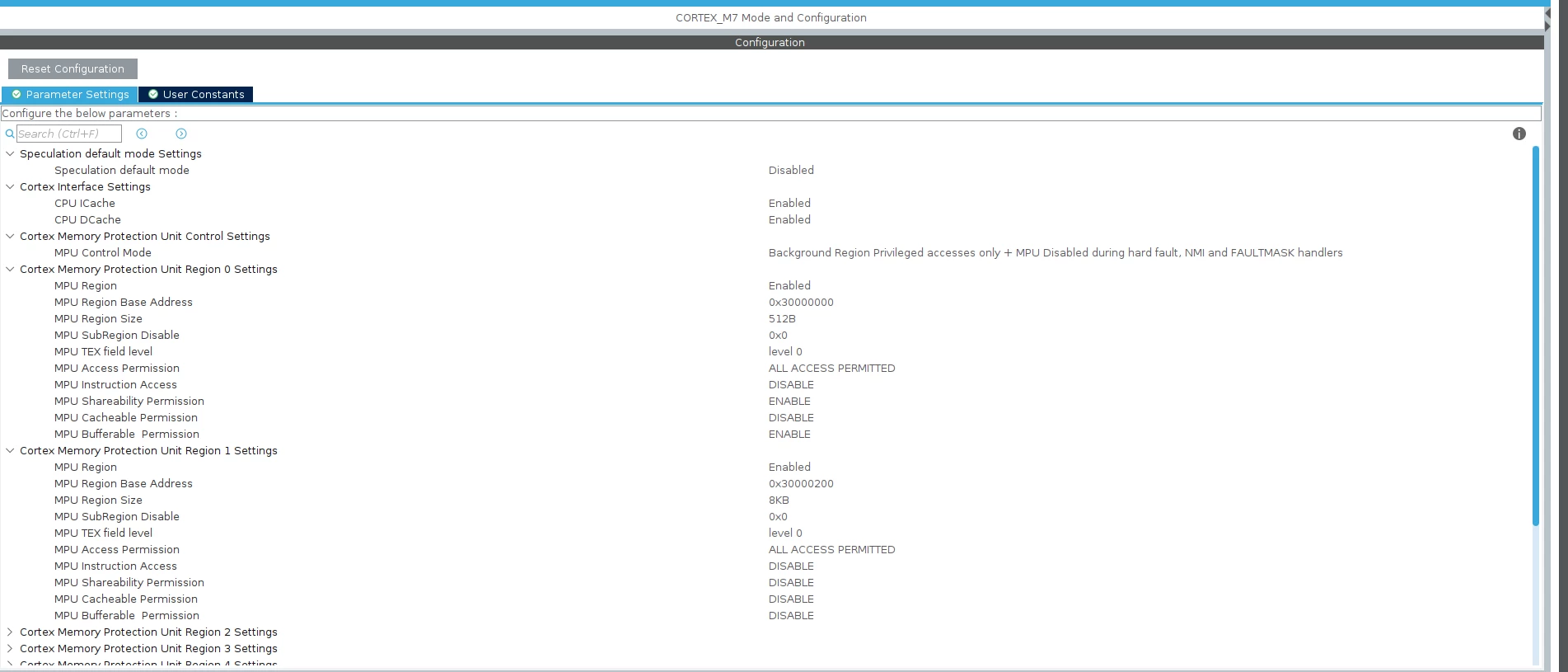

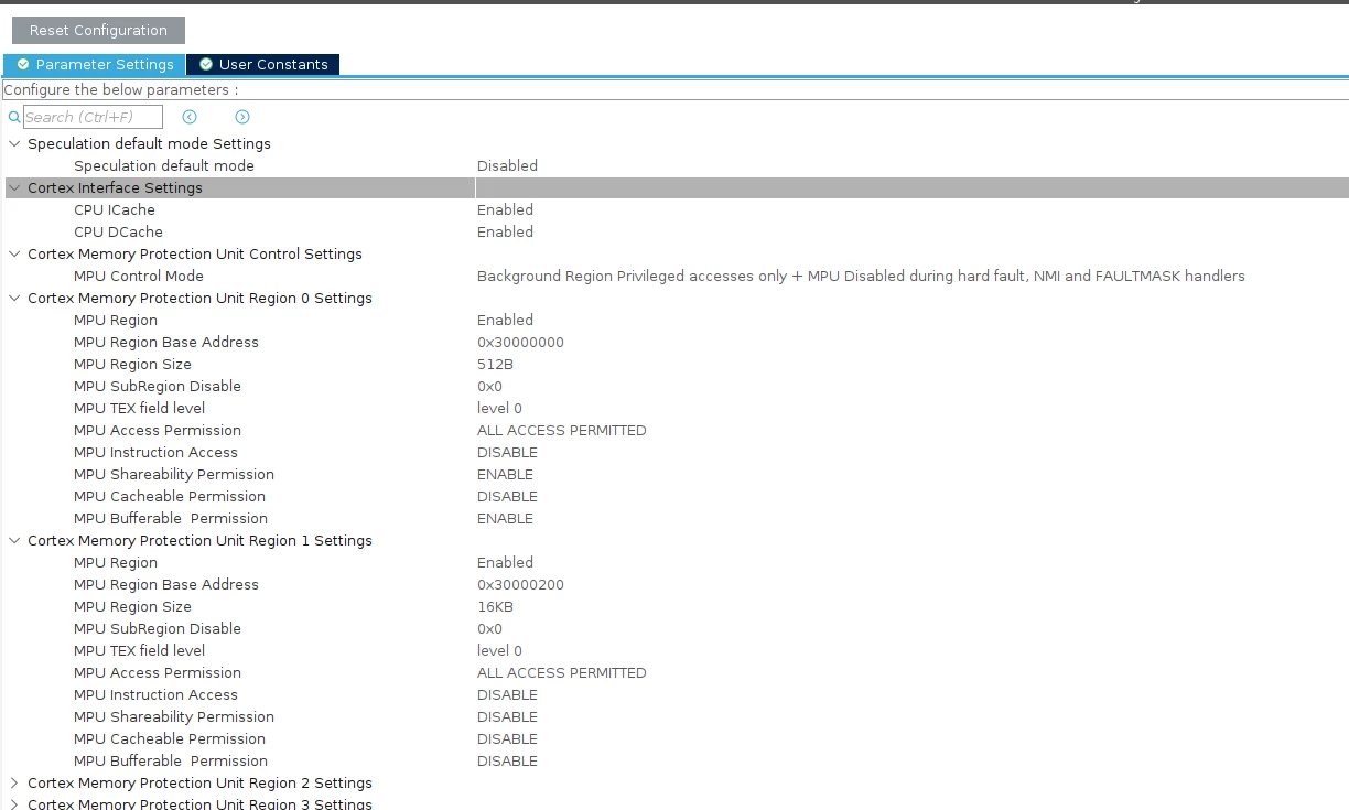

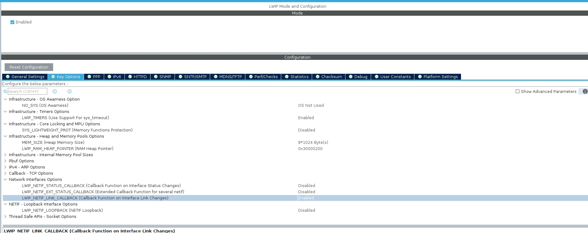

=== EDIT START
I noticed that in the MPU I was requestion 16 KBytes starting from 0x30000200 and I had the LWIP MEM_SIZE as 8 KBytes. I decided to change both, and I got a HardFault.
=== EDIT END
I would appreciate any feedback on this matter from anyone.
Many thanks,
Eduardo.

This issue was solved with the solution for this other related question.
Also, MX_LWIP_Process() inside the while(1) can simply be used instead of all these other changes, since MX_LWIP_Process does exactly that.

Feb 13, 2024 3:20 PM UTC
Hello @eduardo_reis ,
At first glance it seems like you are missing this call in the while(1);
 Ethernet_Link_Periodic_Handle(&gnetif);
The MPU  configuration should be as follows following the example found in the cube firmware :
static void MPU_Config(void)
 MPU_Region_InitTypeDef MPU_InitStruct;
 /* Disable the MPU */
 HAL_MPU_Disable();
/* Configure the MPU attributes as Device not cacheable
 for ETH DMA descriptors */
 MPU_InitStruct.Enable = MPU_REGION_ENABLE;
 MPU_InitStruct.BaseAddress = 0x30000000;
 MPU_InitStruct.Size = MPU_REGION_SIZE_1KB;
 MPU_InitStruct.AccessPermission = MPU_REGION_FULL_ACCESS;
 MPU_InitStruct.IsBufferable = MPU_ACCESS_BUFFERABLE;
 MPU_InitStruct.IsCacheable = MPU_ACCESS_NOT_CACHEABLE;
 MPU_InitStruct.IsShareable = MPU_ACCESS_NOT_SHAREABLE;
 MPU_InitStruct.Number = MPU_REGION_NUMBER1;
 MPU_InitStruct.TypeExtField = MPU_TEX_LEVEL0;
 MPU_InitStruct.SubRegionDisable = 0x00;
 MPU_InitStruct.DisableExec = MPU_INSTRUCTION_ACCESS_ENABLE;
 HAL_MPU_ConfigRegion(&MPU_InitStruct);
 /* Configure the MPU attributes as Normal Non Cacheable
 for LwIP RAM heap which contains the Tx buffers */
 MPU_InitStruct.BaseAddress = 0x30004000;
 MPU_InitStruct.Size = MPU_REGION_SIZE_16KB;
 MPU_InitStruct.IsBufferable = MPU_ACCESS_NOT_BUFFERABLE;
 MPU_InitStruct.IsShareable = MPU_ACCESS_SHAREABLE;
 MPU_InitStruct.Number = MPU_REGION_NUMBER2;
 MPU_InitStruct.TypeExtField = MPU_TEX_LEVEL1;

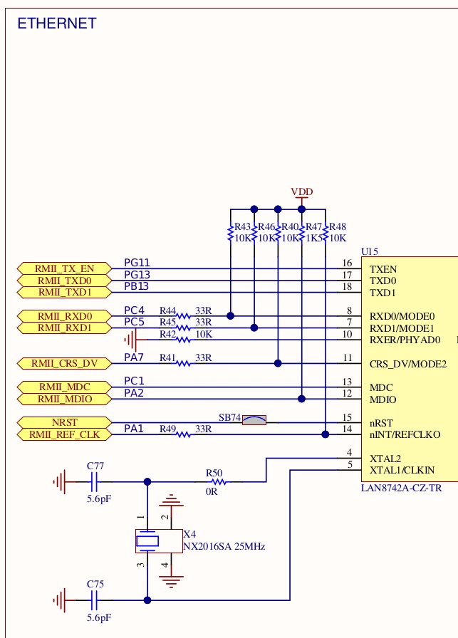

Feb 14, 2024 8:36 PM UTC
Hello @STea,
Thank you for your feedback. I am a bit resistant to pasting C code that will be overwritten when regenerating the .ioc file since my project is constantly evolving and changes made from time to time.
Also, the schematics I have for my board (below)
points to a different pin assignment than the ones you gave in
/* Ethernet pins configuration */
 RMII_REF_CLK ----------------------> PA1
 RMII_MDIO -------------------------> PA2
 RMII_MDC --------------------------> PC1
 RMII_MII_CRS_DV -------------------> PA7
 RMII_MII_RXD0 ---------------------> PC4
 RMII_MII_RXD1 ---------------------> PC5
 RMII_MII_RXER ---------------------> PB10
 RMII_MII_TX_EN --------------------> PB11
 RMII_MII_TXD0 ---------------------> PB12
 RMII_MII_TXD1 ---------------------> PB13
Thank you for the MPU configuration and point this
I got ping to work, however it stops working after sequence 10.
