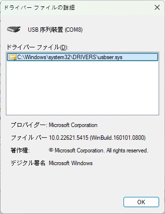

My current task involves switching from USB HOST to USB CDC. I used CubeMX to generate the necessary USB CDC-related files and integrated them into my original program.
On my PC, the program works as expected and is recognized correctly as a COM port.
However, on my coworkers' PCs, the device is not recognized as a COM port.
Both our PC are win11, and after checking, win11 seems no longer requires the installation of the STM Virtual COM Port driver.
Is there anything we can do to further clarify or resolve this issue?

Thank you very much for your response!
Yes, we are using the exact same hardware setup, and we've ruled out the cable and firmware version as potential causes.
When connecting the device to my coworkers' PCs, nothing appears in Device Manager—not even under "Ports (COM & LPT)"—and no error messages are shown. This leads me to believe that the system is not recognizing the device as a COM port at all.
Both PCs are running Windows 11, and they are the same make and model from the same manufacturer, with no additional peripherals connected. So I believe the hardware environment is essentially identical.
Below is a screenshot from my own PC showing the driver information in Device Manager after connecting the USB CDC device:
Also, we have confirmed that this same driver is present on my coworkers' PCs, so the issue does not appear to be caused by a missing driver.
Could there be any other reasons why the device fails to be recognized as a COM port on their systems?

Hi All,
After thorough investigation, we found that the issue was caused by insufficient USB power supply.
This explains the inconsistent test results we observed — some computers could detect the device, while others could not.
Final conclusion:
The device works fine when tested under sufficient power conditions, but fails in other environments.
It appears that due to circuit design limitations, even native USB ports on some computers cannot provide enough power. Only externally powered USB hubs are able to meet the device's requirements.
Thank you all for your support and assistance over the past few days.

August 29, 2025
At first, I noticed that when a PC failed to recognize the USB CDC device, the LED on the USB hub did not light up, indicating that the hub was not supplying power at all.
To find the root cause, I tested all the public PCs in our office, trying to find one that could not recognize USB CDC, so I could use it as a clean sample to install all the applications currently on my PC.
However, all of them were able to recognize USB CDC when using my externally powered USB hub.
So I started testing my coworkers' PCs and found one that couldn't recognize USB CDC. Interestingly, it was able to recognize USB CDC when using an externally powered USB hub.
After that, I tested several other coworkers' PCs, and all of them could recognize USB CDC with the externally powered USB hub.
Additionally, even on the same laptop, different USB ports can provide different power levels. For example, on one of my coworker's laptops, the left USB port could recognize USB CDC, but the right USB port could not.
