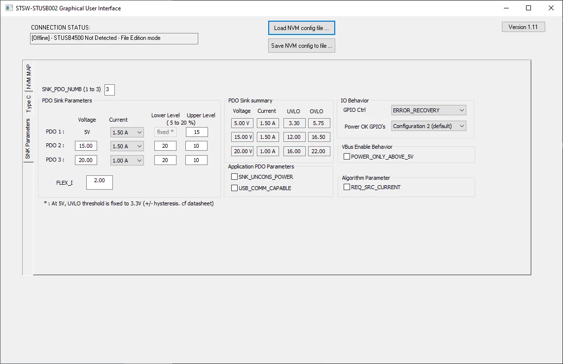

Mmade.11
Jun 4, 2021 6:07 PM UTC
The documentation on the register mapping, especially for the NVM, is extremely poor. I had to go hunting through the ST code to understand how to program the NVM and then port that to Linux. Do you know of a way to identify the 4500 vs the 4500L part? The device id returns the same value for both parts.
Mmade.11
Jun 4, 2021 6:09 PM UTC
And to answer your first question, I do get the SINK PARAMETERS page on v1.11.
Mmade.11
Jun 4, 2021 6:10 PM UTC
MIMBE
MIMBEAuthor
Jun 4, 2021 6:17 PM UTC
I don't know other way than to look at the writing on the chip case! I didn't even notice there was a "L" suffix when I got the chips.
I'm in big troubles, 4500 no "L" isn't avalaible at present time.
So you do get the "SINK PARAMETERS" page on V1.11. I don't know what's wrong with my Windows 10 installation.
And even when entering all PDOPs voltage, current, tolerances parameters by hand doesn't help?
I mean: still no way to have the 4500L comply to the same PDOs than 4500?
Thanks.
Regards.
Matt
Mmade.11
Jun 4, 2021 6:23 PM UTC
We are in the same trouble boat. The ability to get parts is hurting our development as well.
Yes, I do get the "SINK PARAMETERS" page on v1.11. I took a screenshot and it is above.
MIMBE
MIMBEAuthor
Jun 7, 2021 6:23 PM UTC
Hello again,
Yes I do get the same window as far as NO STUSB4500L is connected.
Otherwise this NVM settings page is no more avalible.
I think this is because 4500L NVM mapping is not the same as 4500.
And actually, when the system "sees" a regular 4500 chip, the "NVM
settings" page doesn't disappear!
Matt.
