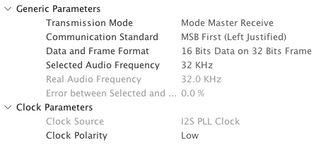

Through Mx, the I2S peripheral is configured as follows:

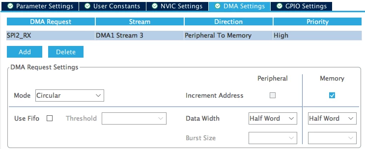

0693W00000GYxgwQAD.pngThen, the DMA is configured as a circular buffer, half-word:

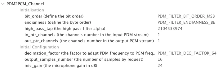

0693W00000GYxe3QAD.pngFinally, I have configured the PDM2PCM library as follows:
0693W00000GYxi9QAD.pngStarting from that configuration I'm having trouble understanding why the PDM2PCM is not working as expected.

The IS2 is configured for a mono microphone (L/R connected to ground).
I'm using the internal HSI (16MHz) to derive the clock (M=10), the PLLI2S is configured with N=192, R = 5 that resulting in 61.44MHz as I2S clock. This is fine with the documentation (Tab.10 AN5027) for mono configuration.
Changing the data size: 24bits on 32bit frame requires that the pdm_buffer[128], but the call to:
HAL_I2S_Receive_DMA(&hi2s2, &pdm_buffer[0], 128/2);
Requires that only half of the size is passed to the DMA because internally one left shift is done for data with 24 and 32bits.
This configuration perfectly works.
However, simply changing the data size: 16bits on 16bit (or 16bits on 32 bits) frame requires to call:
HAL_I2S_Receive_DMA(&hi2s2, &pdm_buffer[0], 128);
Passing the full size of the buffer.
However, this solution results in a distorted audio signal.
Looking with the debugger, the I2SDIV and ODD are the following:
  • 16bit data on 16bit frame (I2SDIV = 0x3c and ODD = 0x00) -> Fs = 16kHz
  • 24bit data on 32bit frame (I2SDIV = 0x1e and ODD = 0x00) -> Fs = 16kHz
0693W00000GZOb0QAH.pngThe resulting Fs for both configuration are correct.
Could you help me understand? Have the pdm_buffer the wrong size?

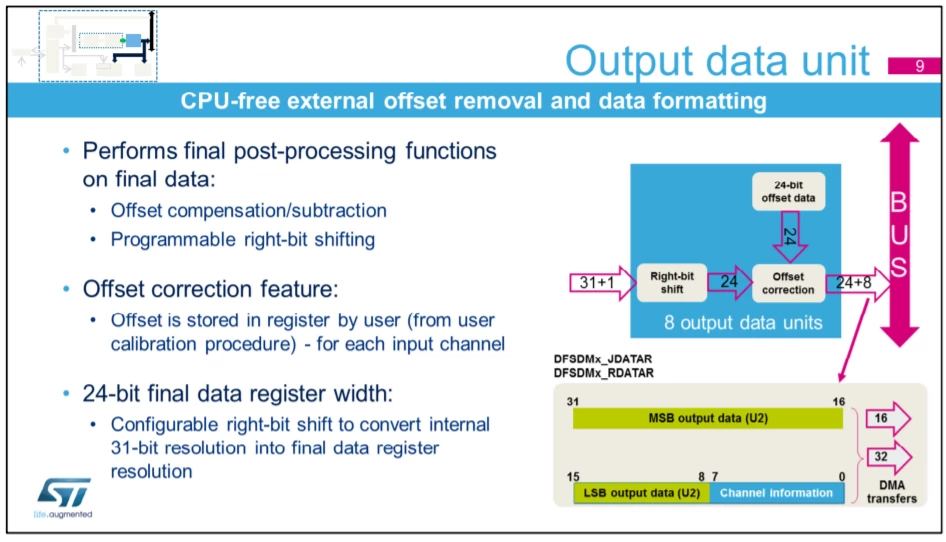

I got this feedback from our experts: they are referring to the X-CUBE-MEMSMIC1 library, and they are asking you whether you are using this function pack.
If so, the I2S peripheral configuration in the MEMSMIC1 with the PDMFilter function works (only) if it is set in that way (i.e. 24 bit on 32).
This because, during the data conversion, registers of specific 24-bits peripherals are used, together with local variable at 32 bits.
For this reason, if you change just a configuration parameter in the I2S configuration, then the procedure works no more.
See for example this presentation --> STM32H7-Peripheral-Digital Filter for SD Modulators interface (DFSDM)0693W00000Ho4JeQAJ.pngIn any case, during the conversion the "useful" data have an extension of 24 or 32 bits, never at 16 bits.
-Eleon
