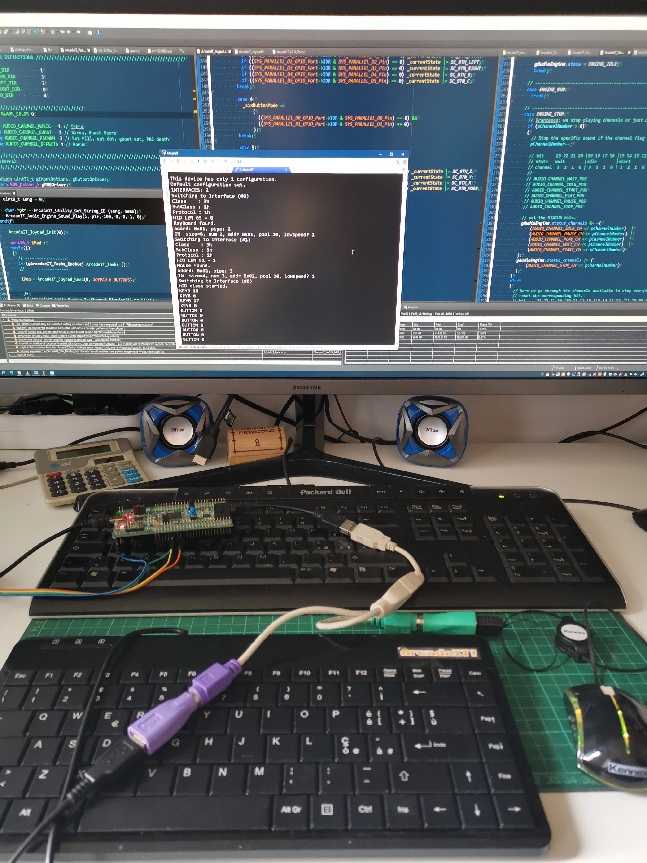

Digimorf
DigimorfAuthor
September 17, 2020
I had an interesting test with STM32F4HUB code on the Discovery F4. Since all keyboard and mice that I have didn't work together through a HUB, I tried to understand if combo devices could work better, and I got an interesting surprise: do you remember those old adapters USB to PS/2 for using PS/2 Keyboard and mouse on one USB port? Good, that worked!
Not only with PS2 devices but also with USB kyb&mouse through a PS2 to USB single adapter on each end.
So I was able to use the USB keyboard and mouse through those adapters , see attachment. There are still some weird behaviors when resetting and starting the Discovery, but when the firmware doesn't "freeze" it works perfectly :)
0693W000003RwNOQA0.jpgWhat do you think?
This is the log text of the STM32F4HUB terminal:

This could be an easy solution to use those old devices also :)
Pavel A.
September 17, 2020
Nice. Cypress is a good company, their stuff is reliable.
By the way, once we've made a STM32F4 based host for USB keyboard & mouse and PS/2 keyboard and mouse - all in one.
It was kind of a KVM switch. For the remote (device) end I wanted to use these PS/2 to USB adapters, because they are LS and very compatible with everything.
-- pa

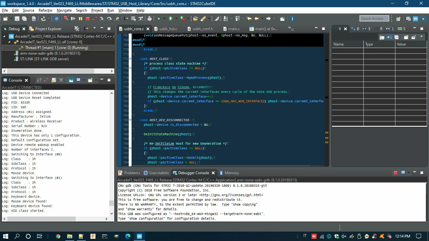

Digimorf
DigimorfAuthor
September 27, 2020
From my last research I realized that the latest version of USB Host library by ST seems not supporting multiple interfaces. More precisely , considering the file "usbh_core.c", in the case "HOST_CHECK_CLASS:" of the function "USBH_Process", the only interface considered is the 0 indexed:
phost->pClass[idx]->ClassCode == phost->device.CfgDesc.Itf_Desc[0].bInterfaceClass
The code STM32F4HUB , instead checks more interfaces, in fact the interfaces is updated and then analyzed.
 phost->pActiveClass = NULL;
 uint8_t itf = phost->device.current_interface;
 for (idx = 0; idx < USBH_MAX_NUM_SUPPORTED_CLASS ; idx ++)
 if(phost->pClass[idx] != NULL)
 if((phost->pClass[idx]->ClassCode == phost->device.CfgDesc.Itf_Desc[itf].bInterfaceClass) ||
 (phost->pClass[idx]->ClassCode == 0x03 && phost->device.DevDesc.bDeviceClass == 0xFF) )
 phost->pActiveClass = phost->pClass[idx];
I have tried the STM32F4HUB library with a wireless keyboard and mouse composite and it reads both interfaces correctly

I am trying now to modify the ST driver to read multiple interface, but do you have an idea or suggestions ?
Digimorf
DigimorfAuthor
October 2, 2020
The work is going further, now the interfaces of the wireless device are detected correctly. The driver still needs fixes because the data coming from the mouse seem to be misaligned. The keyboard is ok instead. When standalone keyboard or mouse are plugged in, everything is perfect. So still a bit of work is waiting for me, but I am getting there. :)
