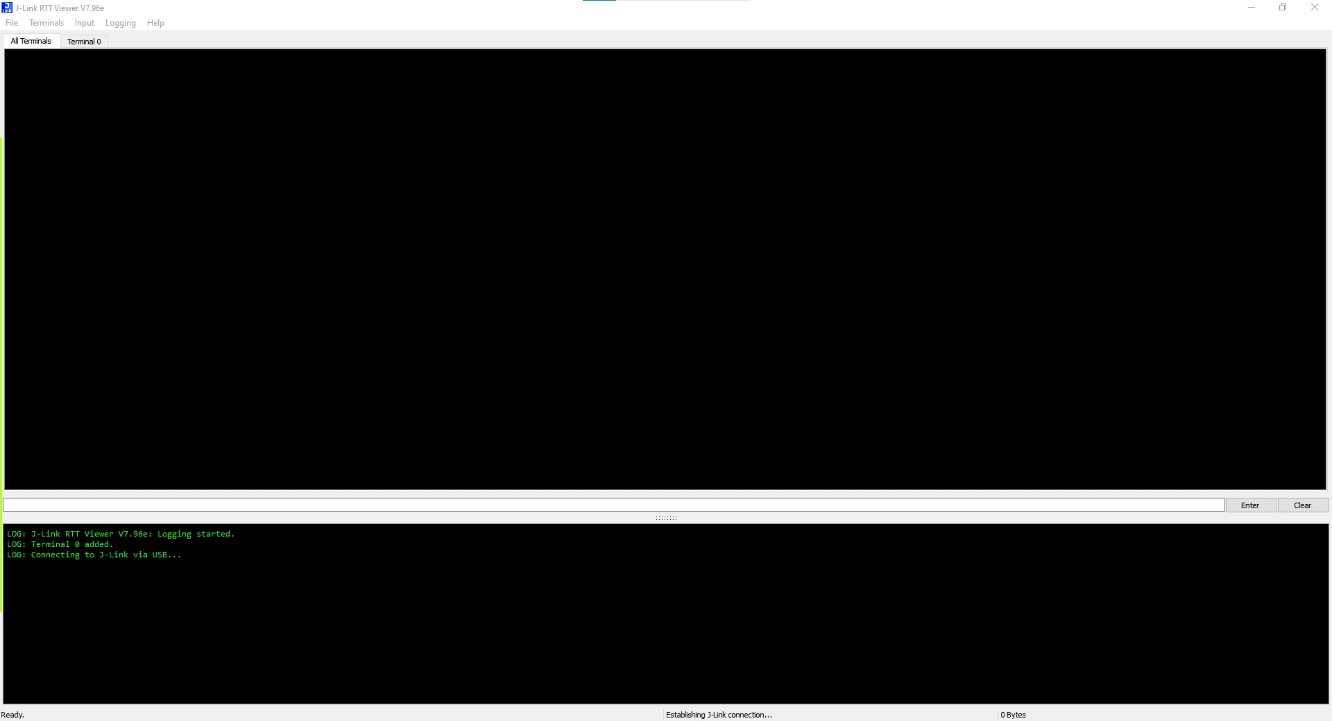

How to transmit a printf to RTT Viewer.
Hi together,
i am searching for a equivalent of the J-Link RTT-Viewer, on which i can display something for demonstration purposes. It is to simply demonstrate that i connection can work just like a in-built Segger J-Link.
FYI: I am using a NUCLEO-C031C6 without any external tools

May 22, 2024 2:24 PM UTC
Thank you for your message! Sorry for the confusion.
I am simply using the NUCLEO-C031C6 which does not offer any in-built Segger J-Link tool. I also do not have a external J-Link tool...
My wish is to find the functionality of the Board which allows to communicate between board and laptop and display communication in a RTT-Viewer (as shown in picture attached). The purpose is to demonstrate.

@drothammel wrote:
I am simply using the NUCLEO-C031C6 which does not offer any in-built Segger J-Link tool. I also do not have a external J-Link tool... id
Segger have a facility to convert an ST-Link into a J-Link:
https://www.segger.com/products/debug-probes/j-link/models/other-j-links/st-link-on-board/
although your Nucleo isn't on the list on that page - so check with Segger first if you want to try that.
RTT is proprietary to Segger - so you won't be able to do that without a J-Link of some sort.
Why not just use a UART and terminal ?
