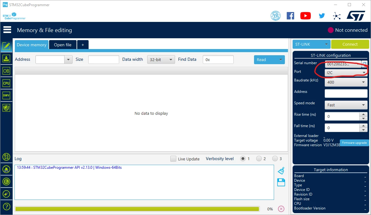

CChic.1
CChic.1Author
Apr 5, 2024 7:15 PM UTC
I think there was a video series from ST showing how to bootload over I2C. I think it uses the Bridge I2C connections to connect. Simply click the drop down and select I2C and it will use the Bridge SCL and SDA on the ST Link V3SET and V3MODS. I'm still waiting to get my board back from assembly to try it but I've got my Saleae (https://www.saleae.com/?gad_source=1&gclid=CjwKCAjwwr6wBhBcEiwAfMEQs4GXwrrPlFo2AB3dqAZQtFRQsvU3W66sSxiCjnTRhJ8gE8JYazVw3RoCGbIQAvD_BwE) logic analyzer ready to go, I hope to record CubeProg sending the file and reverse engineer that to understand the actual writing. If I'm ever successful, I'll try to do a write up for other newbies like myself to follow.

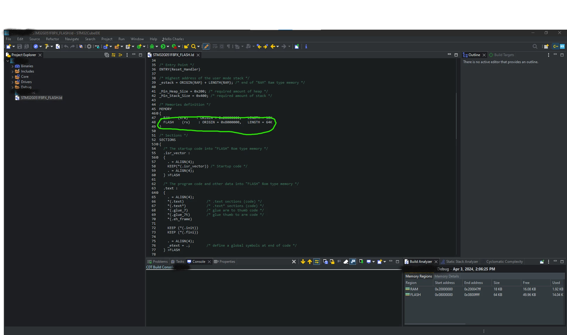

Here's a screenshot of my linker script, is this what I'm looking for as the definition of the start of my user code:
Tesla DeLorean
Guru
Apr 5, 2024 7:29 PM UTC
Ok, so 0x08000000, the base of FLASH in these parts. Could be deep in like 0x08008000 (+32KB) if you had your own loader that's more aware of your board's hardware.
