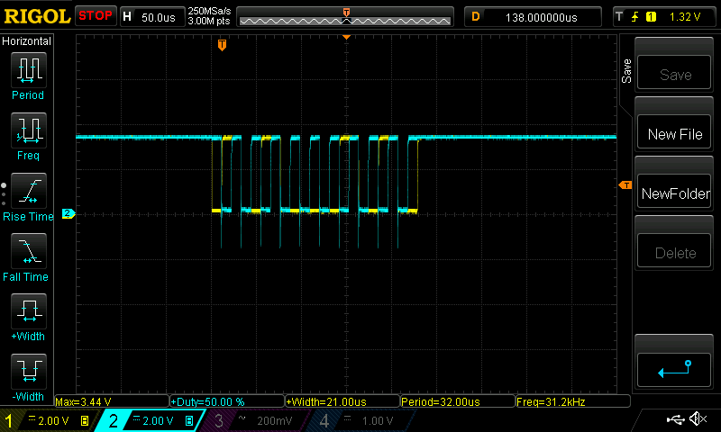

In a master/slave system where I use stm32H7 as master and STM32G030F6 as slaves, I am trying to flash the slaves with the master using the System memory bootloader.
I can successfuly get to STM32G0 system memory (either on an empty one or one that I programmed earlier with a jumpTo code). However once I am in system memory, the slave is unresponsive to I2C addressing.
I am using I2C1 (PB6 as SCL and PB7 as SDA), and sending the address 0xA2 indicated in AN2606, but the STM32G0 slave doesn't ACK the address.
I have triple checked the hardware part, I am using a slow 25kHz I2C signal with the recommanded 1.8kOhm pull-up resistors.
Here is the transmission :
It looks fine to me, the master seems to properly send the 0xA2 write command, but the slave doesn't pull the SDA line low on last clock. Unless of course I am not understanding I2C correctly.
I have checked multiple time the reference manual, AN2606 and AN422, I just don't understand what I am missing, hope someone can help !
Cheers,
Mathieu

waclawek.jan
June 9, 2020
Is there any activity on other pins which would make the bootloader to go to some other branch than I2C1? There's also an erratum in AN2606 for older versions of the bootloader - you may want to check that.
If you have SWD connection, you can debug the bootloader as you'd debug your own program (except you don't have the symbols available).

Mathieu Frohlich
June 9, 2020
I did some wiggling to set-up an UART connection to my slave, and it works !
I can communicate with the STM32G030F6 bootloader.
When tasking the version, I get 0x31, which I guess is the version of the USART bootloader, not of the bootloader itself.
So my guess is, my STM32G030F6 chip comes with v5.2 of the bootloader. As stated in AN2606 it contain a bug which make the bootloader stuck if PA3 stays low. I am going to try I2C tomorrow with a pull-up on PA3 just to make sure it is the case, but either way, I'm going to have to change my hardware since I was using PA3 as an ADC pin :(
At that point the easiest thing to do is just switch to an UART connection for flashing my slaves. I hope this thread can save some headaches in the future.
Cheers,
Mathieu

MMisa
December 15, 2020
It seems that is wrong i2c address in the manual - it should be not 0x51, but 0x56. Now I can succesfully detect CPU with the stm32flash software. Unfortunatelly it seems that block erase is not working with the stm32flash tool. I didn't try mass erase and flashing yet (I have calibration values stored in the flash, so I am waiting to new boards for further tests).
