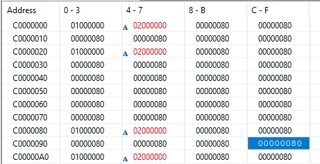

I'm using a STM32H743 and IS42S32160 SDRAM.  The SDRAM is in bank1, and I followed the instructions on how to setup the external memory from this guide:
https://community.st.com/t5/stm32-mcus/how-to-set-up-the-fmc-peripheral-to-interface-with-the-sdram/ta-p/49457

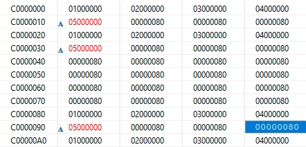

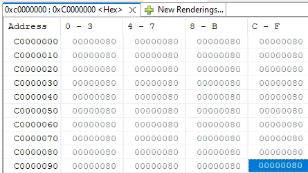

i can read/write the entire bank (64Mbytes) one word at a time, but then when I run a memory test, where it uses a pattern (incrementor) at each location the memory test fails.  Also, in debug mode, when I step through the program and watch the memory window, i noticed weird things happening.  Before this memory tests starts, the entire 64mb is initialized to x80000000 as shown below:

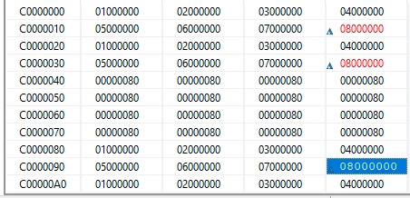

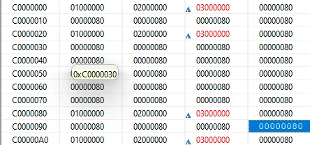

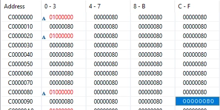

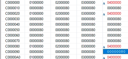

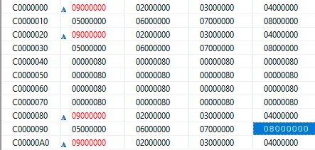

Now the first write happens to location 0xc000_0000 <= 0000_0001, which seem to write there, but it also writes or reads  from addresses:  C000_0020, C000_0080, C000_00A0
Something similar happens to the next memory locations:
etc... it does that through out the entire memory space.  I checked the schematic, and all the address lines seem to be routed properly (and i was able to initialize the sdram), so I don't think it is that.  I tried this memory test program on multiple boards, exact same issue on all.
The memory clock is setup as per the aforementioned document (200Mhz / 2)
I double checked the timing as per the document and everything seems to be ok.

ok, it seems there was unetched piece of copper between A7 and A5 on all the boards.  I removed that small piece of copper and it seems to be working properly.
