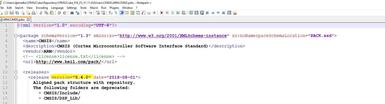

Sep 9, 2024 7:50 AM UTC
Hello @White_Fox and welcome to the Community :),
Which CMSIS version are you using?
-->The first difference is, that I do not have a folder "PrivateInclude"
Note that, the CMSIS version integrated in STM32CubeF3 1.11.5 is "5.4.0".
As mentioned in this FAQ
Thank you.
Kaouthar
