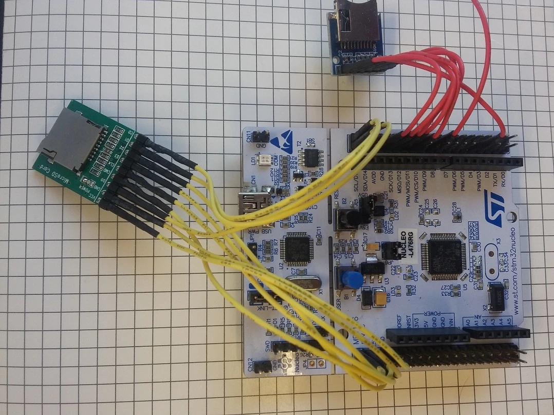

I'm having a lot of difficulty getting FatFS working with SDMMC on my STM32L476 (RG-Nucleo) board. I'm working from code generated by CubeMX and have followed a number of forum posts suggesting alterations to get SDMMC working -- for instance,
https://community.st.com/message/203639-sdmmc-on-stm32-l476-l4
 . Currently I'm getting an infinite loop when calling f_mount which I can trace back to
stm32l4xx_hal_sd.c:
while(!__HAL_SD_GET_FLAG(hsd, SDMMC_FLAG_RXOVERR | SDMMC_FLAG_DCRCFAIL | SDMMC_FLAG_DTIMEOUT | SDMMC_FLAG_DBCKEND))
This loop goes on infinitely -- it seems none of these flags are being set? What are some likely causes of this problem?
#hal #sdmmc #f_mount #stm32l4+ #fatfs

>> I'm working from code generated by CubeMX..
You need to stop doing that, the monkey inside is broken.
I'll rebuild the demo in a minute.

Thanks for the picture -- it seems our wiring is identical.
Sadly I have 4-5 other peripherals that need configuration for my project so Cube seems like the path of least resistance.
I've tried adapting ST's non-Cube HAL example (for L476G, which has an onboard SD slot), but maybe I ought to try harder. So far, however, it seems I just can't get it working even without Cube.
If it's of note, I believe the one 'good' flag above is FLAG_DBCKEND, meaning a data block was received and the corresponding CRC passed. It hangs here until the timeout is reached, returning HAL_SD_ERROR_TIMEOUT. It's not failing the CRC either, so the data just isn't being received.
