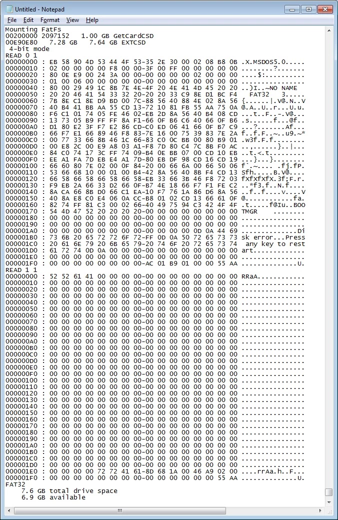

Sorry, where/how would I 'dump' the block contents?

You'd instrument the disk_read and/or disk_write functions to call dumping routines that show you what's in the memory buffer.

I'm trying to print the buffer like this inside f_write():
 	 	while (*buff){
 	 		msglen = snprintf(msgBuf, 255, "%02X/%c ",(unsigned int) *buff,(char) *buff);
 	 		buff++;
			serialDisplay(msgBuf,msglen);
for any write occurrence whether or not it fails. This just gives me the same value out, 'B'. What am I missing?
