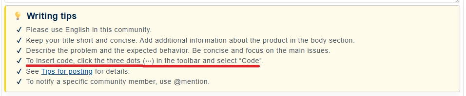

Hello ​@4anu and welcome to the ST community,
1- In next time please use insert code button to share your code:
2- This post is related to Ethernet and LWIP nothing todo with CubeIDE, it shouldn’t be posted in STM32CubneIDE forum board but rather in STM32 Embedded software.
3- You can refer to the knowledge base article: How to create a project for STM32H7 with Ethernet and LwIP stack working
I’m editing your post and moving it.
Thank you for your understanding.
