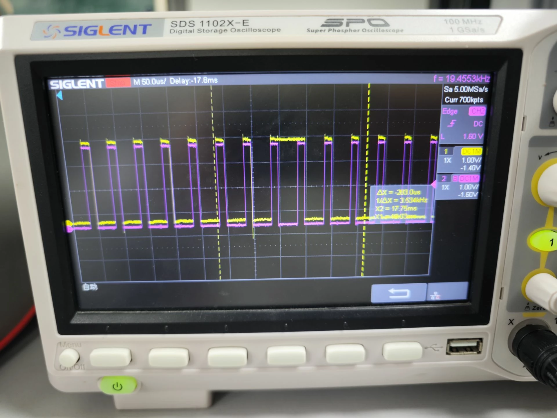

Configure stm32g474 HRTIM ?
tima 的pwm输出正确,但是timb的pwm一个周期出现无法reset的情况

void HAL_HRTIM_RepetitionEventCallback(HRTIM_HandleTypeDef *hhrtim, uint32_t TimerIdx)//20kHz中断
if (TimerIdx == HRTIM_TIMERINDEX_TIMER_A)
HAL_HRTIM_WaveformOutputStart(&hhrtim1,HRTIM_OUTPUT_TA1 | HRTIM_OUTPUT_TA2 | HRTIM_OUTPUT_TB1 | HRTIM_OUTPUT_TB2 | HRTIM_OUTPUT_TC1 | HRTIM_OUTPUT_TC2);
//HAL_HRTIM_WaveformOutputStart(&hhrtim1,HRTIM_OUTPUT_TB1 | HRTIM_OUTPUT_TB2);
hhrtim1.Instance->sTimerxRegs[0].CMP1xR = SPWM_400[i];
hhrtim1.Instance->sTimerxRegs[0].CMP3xR =SPWM_400[399-i];
hhrtim1.Instance->sTimerxRegs[1].CMP1xR = SPWM_400[i];
hhrtim1.Instance->sTimerxRegs[1].CMP3xR = SPWM_400[399-i];
The two PWM is not the same as the picture shows.how to solve it.every period has a wrong pwm(50Hz).TA1(the red one) is correct while the TB1(the yellow one) is not the same as i set.

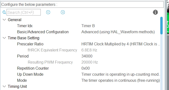

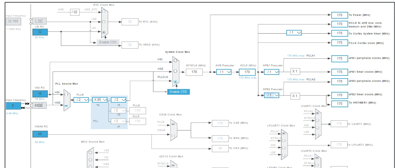

Jul 3, 2025 8:14 AM UTC
What about CKPSC? Make sure to adjust the clock prescaler and timing parameters to ensure cycle accuracy.
xcmAuthor
Jul 3, 2025 9:01 AM UTC
which one?what can I do ?
