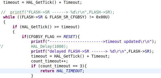

Hi everyone,
i am using the stm32g0b1cet6 controller. in which I am working with flash memory. I am using the FLASH_WaitForLastOperation function. In that function, one flash SR register's CFGBSY bit is not reset, and due to that all other flash write and erase processes it not working.
this issue is coming randomly.
_legacyfs_online_stmicro_images_0693W00000bjLttQAE.pngbefore calling FLASH_WaitForLastOperation function I am clearing error flags as shown below
__HAL_FLASH_CLEAR_FLAG(FLASH_FLAG_OPTVERR);
__HAL_FLASH_CLEAR_FLAG(FLASH_FLAG_OPERR);
__HAL_FLASH_CLEAR_FLAG(FLASH_FLAG_PROGERR);
__HAL_FLASH_CLEAR_FLAG(FLASH_FLAG_WRPERR);
__HAL_FLASH_CLEAR_FLAG(FLASH_FLAG_PGAERR);
__HAL_FLASH_CLEAR_FLAG(FLASH_FLAG_SIZERR);
__HAL_FLASH_CLEAR_FLAG(FLASH_FLAG_PGSERR);
__HAL_FLASH_CLEAR_FLAG(FLASH_FLAG_MISERR);
__HAL_FLASH_CLEAR_FLAG(FLASH_FLAG_FASTERR);
__HAL_FLASH_CLEAR_FLAG(FLASH_FLAG_RDERR);
can someone please provide some input ASAP.

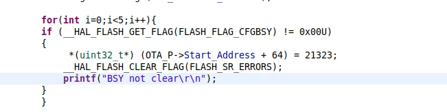

Dthum.1
Dthum.1Author
November 28, 2023
Hi Goutham,
Thanks for your input, I have tried with your suggestion, i found it is working as of now(tried 15 times)
Have you found the RCA for this issue? Why this CFGBSY is not clearing?
Dthum.1
Dthum.1Author
December 7, 2023
Hi Goutham
Update: Thanks for your valuable input, I have validated your fix on my setup by testing it 120 times, where I was facing the issue. it has worked each time and no issue I have found with this fix.
thanks, a lot.
here, what I have done is similar to your fix.
