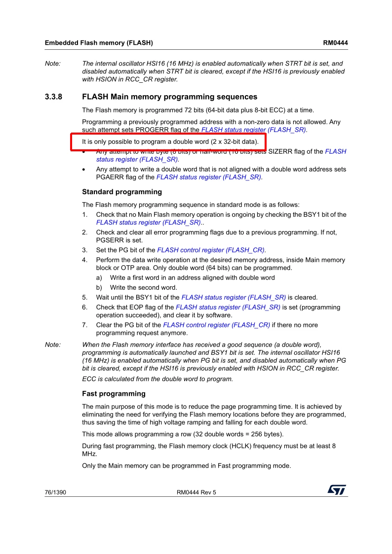

I had this issue on STM32G070 and initially used solution from the topic. But since this is not reflected in errata I investigated it further. And...
Make sure Your writes are aligned to 64bits / 2x 32bits. If You write odd number of 32bit words, CFGBSY stays on forever. After aligning writes to 8 bytes problem never came back.
waclawek.jan
Mar 8, 2026 8:55 PM UTC
Well, yes, but it's hardly surprising, as that's exactly what the manual says:
