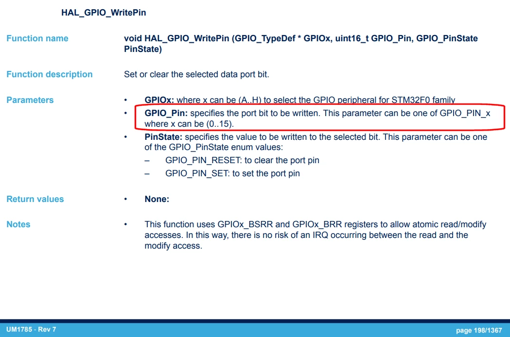

PS:
See: https://community.st.com/t5/stm32-mcus-embedded-software/array-for-gpio-pins/m-p/654354/highlight/true#M46755
But the documentation:
Is not at all clear that GPIO_Pin is a bitmask.

The only purpose of the "ALL" is to be used in the "checker" macro, where it verifies that at least one of those 3 fields is nonzero and all other bits not occupied by those fileds are zero.
The HAL_GPIO_WritePin() you've quoted above *is* different from the initialization and it may indeed require only one pin at a time (not going to dig into that either).
