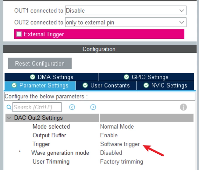

My STM32CubeMX config is:
And my code in main() is:
HAL_DAC_SetValue(&hdac1, DAC_CHANNEL_2, DAC_ALIGN_12B_R, 4095);
HAL_DAC_Start(&hdac1, DAC_CHANNEL_2);
But the PA5 have no voltage.

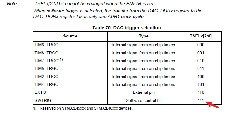

 But in rm0394-stm32l41xxx42xxx43xxx44xxx45xxx46xxx-advanced-armbased-32bit-mcus-stmicroelectronics.pdf the TSELx config 0b111 with SWTRIG:
SO the code in check if software trigger enabled have error:
