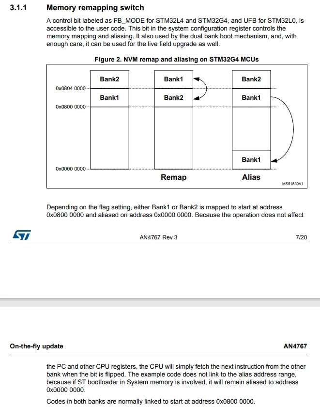

Oct 17, 2024 6:24 PM UTC
Did you try to alter the linker script for the application and change the Flash origin?
As you see in AN4767 that when FB_MODE is set, the addresses are remapped:
