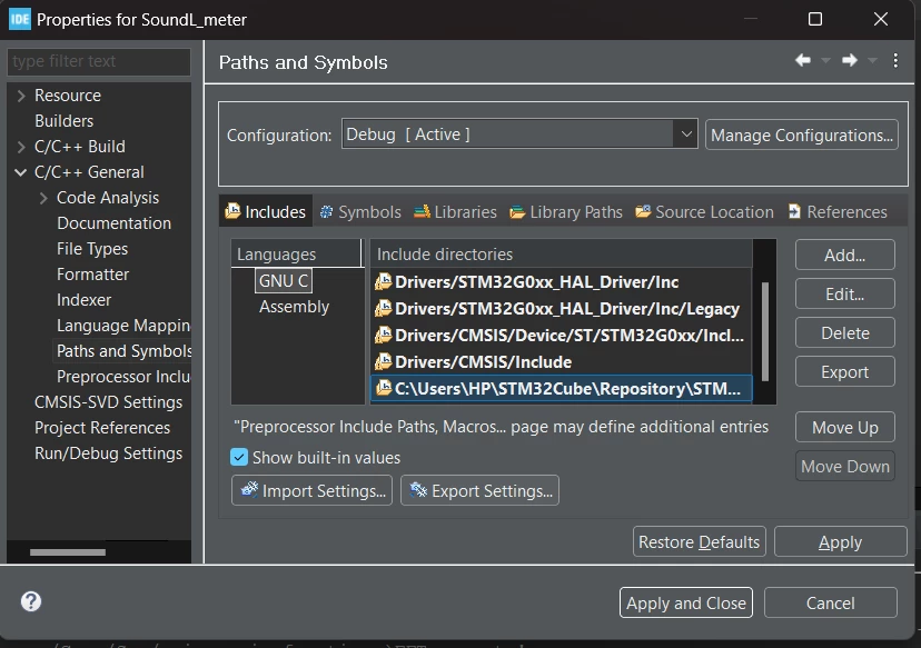

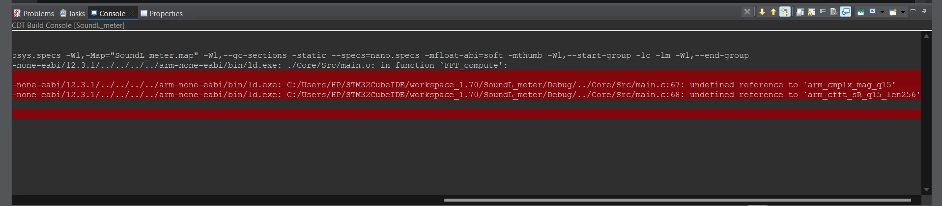

Hey I am trying to use CMSIS DSP library to perform FFT of i2s data from a mic but it is showing error after using the FFT functions but is compling if only library is added is there any thing I have missed

Linker errors occur because you don't add the library or it's source to the project.
An INCLUDE file typically doesn't add code, it provides the inferface details, the code behind the library still needs to be accessible to the LINKER

I'm not using your tools. But standard compiler/linker methods dictate
Step#1 include paths for tools, and add #include in your source
Step#2 Add the library .a file if prebuilt so the linker knows where the function bodies live, or add library source files to your project directly so the compiler compiles them.
