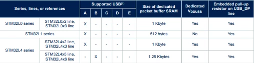

As per this documentation, STM32L476 support the interface B: USB 2.0 OTG_FS, that is, USB 2.0 FS device/host/OTG controller with on-chip FS PHY
and it had an embedded pull-up resistor on USB-DP line.
and the connection as per the documentation should be as the following:
In my case, the stm32 is self powered so I have no connection between the VBUS and the stm32 power. But I don't have the resistor bridge, VBUS isn't connected to anything.
In section 3.1.1, for self powered applications, "It is recommended to implement a resistor bridge (refer to Section 2.6 for more details)". However, in section 2.6, "Based on the USB specification, a USB device must use VBUS sensing detection. When the device detects the host presence, it connects its pull-up resistor to either a D+ or D- data signal. This allows the host to detect the device presence on the bus.The device is self-powered. VBUS sensing is mandatory."
I do have a pin not used next to PIN PA9 (VBUS_OTG_FS_VBUS) which is the USB voltage sensing pin, what I'm thinking about is to weld this pin to the PA9, put it as an output to power the PA9. In this way, the pull-up resistors are always connected or I can manage to power it in the software when I need it.
What do you think about it? I think it's impossible to connect the pull-up resistor from the software.
