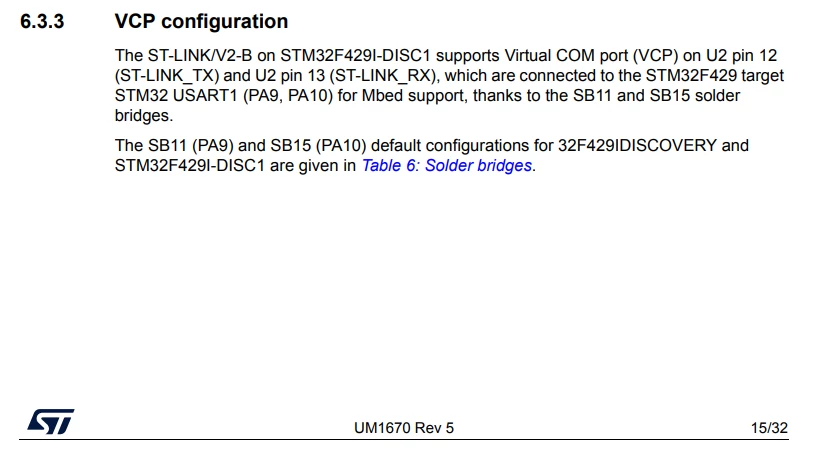

The 32F429IDISCOVERY manual says they are the correct pins:
https://www.st.com/resource/en/user_manual/um1670-discovery-kit-with-stm32f429zi-mcu-stmicroelectronics.pdf#page=15
via: https://www.st.com/en/evaluation-tools/32f429idiscovery.html#documentation
@chachamaru are you sure that your board hasn't been reconfigured (SB11 and/or SB15)?

mƎALLEm
mƎALLEmBest answer
Nov 6, 2025 4:24 PM UTC
Unfortunately I can't try with Tera Term right now but I can try with Hercule.
Attached a project where "Hello World" is printed in Hercule interface:
The HyperTerminal config:
PS: the code you shared in your last post should be used with two boards. You need to read the readme file of the example before to run the example.
Ensure: SB11, SB15 are soldered and JP4 is not fitted.
Hope that helps
