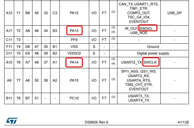

Andrew Neil
September 5, 2024
@Sudharshan wrote:
Could you explain the disable  or reconfigure the SWD pins mean here ?
The SWD lines (SWDIO and SWCLK) are on PA13 and PA14:
So, if your code does anything to PA13 and/or PA14, it will break the debug connection.
