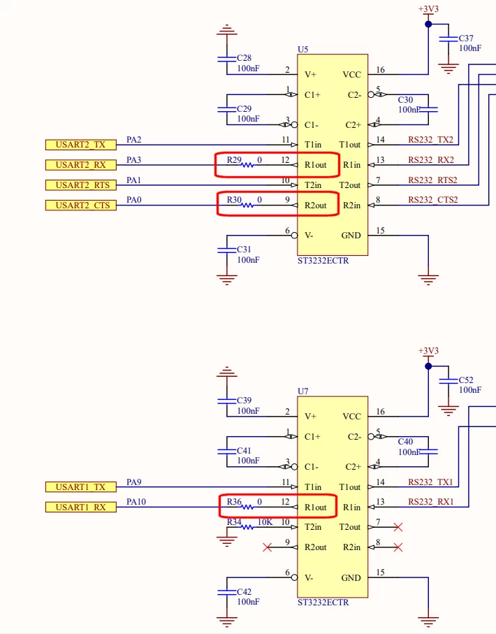

i am using stm3210e-eval board which has stm32f103zgt6 mcu and i trying to send data on its uart but i am not able to receive any. i am trying to receiving it through blocking mode
uint8_t rx[10];
HAL_UART_Receive(&huart2,rx,1,HAL_MAX_DELAY);
HAL_Delay(1000);
now this is the code and i have put the breakpoint on HAL_Delay so that as soon as data is received it will next stop on HAL_Delay but it does not break it stays stuck into uart function there and is not data getting received. I am using FL232RL to send data from putty to mcu pins of uart i can ensure that data is being sent from putty because when i hit enter onto putty i can see the green led getting blinked with each send of data but i am not getting anything over there but i can send data from mcu to putty i can see that clearly so what is happening
PS: i have double checked the baud rate it correctly set and the uart is transmit and receive mode i have tried changing it to receive mode only but that doesn't help
As noted in that previous thread, the stm3210e-eval board has RS232 Transceivers connected to the MCU's UART pins:
https://community.st.com/t5/stm32-mcus-products/uart-sending-some-else-data-and-not-as-intended/m-p/687059/highlight/true#M252609
So you'll need to disconnect those before connecting your FL232RL ...

well i cannot just disconnect those because they are on board and soldered and i am not sending the data onto rs232 pin but the actual MCU pins given as header PA2 and 3 or PA9,10
Andrew Neil
Jun 19, 2024 9:44 AM UTC
Are there not any links or solder bridges to disconnect them?
You can't just connect the FL232RL output - because it will be shorted to the ST3232C output!
Or just get yourself a USB-to-RS232 converter, and connect to the DE9

Yes, there are zero-ohm links on every output from the ST3232C chips  to the MCU input pins:
unsigned_char_array
