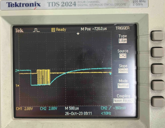

Below is image for ST-Link for nRST and SWCLK when i tried to connect with MCU using STM32Cubeprogrammer.
2 blue channel is nRST, 1 yello channel is SWCLK.
Thank you.

kevin1971Author
October 26, 2023
Blue 2 channel and yellow 1 channel are little bit malfunction to measure the voltage.

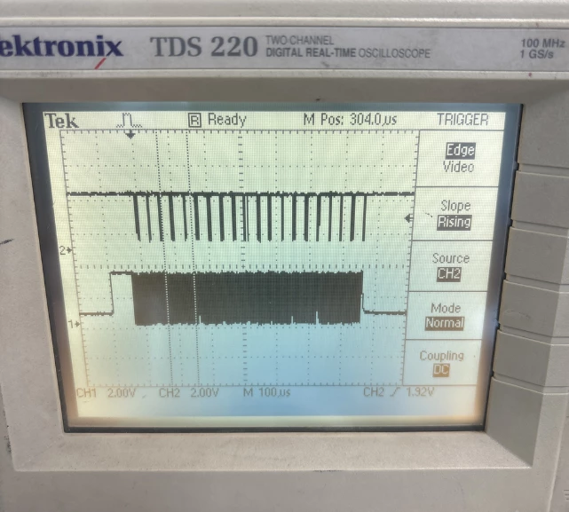

Hi
Below is SWDIO, SWCLK waveform when I tried to connect with MCU using STM32CubeProgrammer.
Thank you.

Is there some issue with the grounding here?
Your diagram here has GND and SWDIO switched. Is the wiring harness correct?

Hi Tesla,
In first picture, The oscillator is liitle bit malfunction to measure the voltage as you indicated.
However, second picture is good to measure swdio, and swclk waveform.

Tesla DeLorean
Guru
October 26, 2023
Has this ST-LINK successful connected with any MCU ?
The connectivity and functionality of this MCU looks to be non-functional. Can you connect via the System Loader with BOOT0 High? Say, getting the UART protocol to respond to interaction? Has the device been set into a read protect mode? Disabling th SWD?
