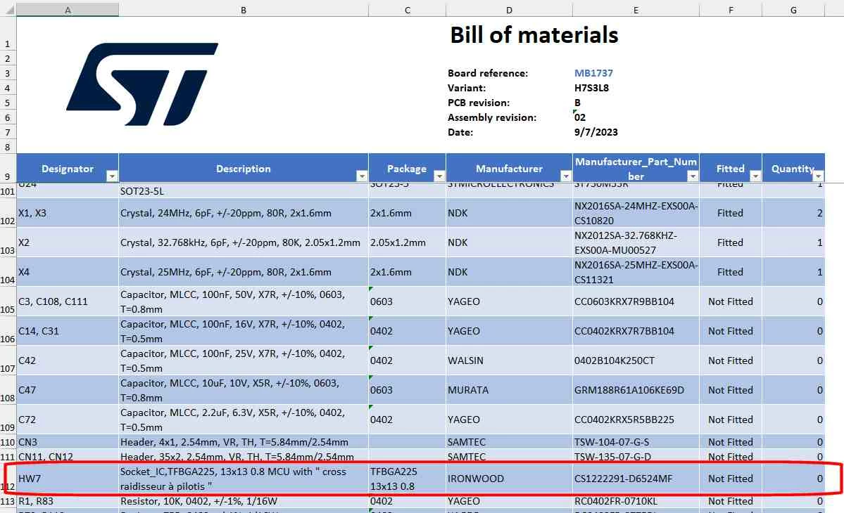

Is there any utility in the holes and silkscreen circles around the TFBGA225 on the NUCLEO-H7S3L8?  It appears to be the same pattern on the Discovery board, suggesting it might be for BGA placement or maybe a heatsink.

See this thread - it's probably for a ZIF socket used internally by ST for (early?) development.
Perhaps @mƎALLEm can confirm?
PS:
As @waclawek.jan noticed in the other thread, it's in the BoM:

These indeed are holes for a TFBGA225 socket.
The boards with socket are available only for ST internal developement usage not available on the market.
The PCB is common for the developement and market versions.

the hole and silk screen are socket for TFBGA225, if you use chips for board production, you don't need put the holes and silkscreens on .
