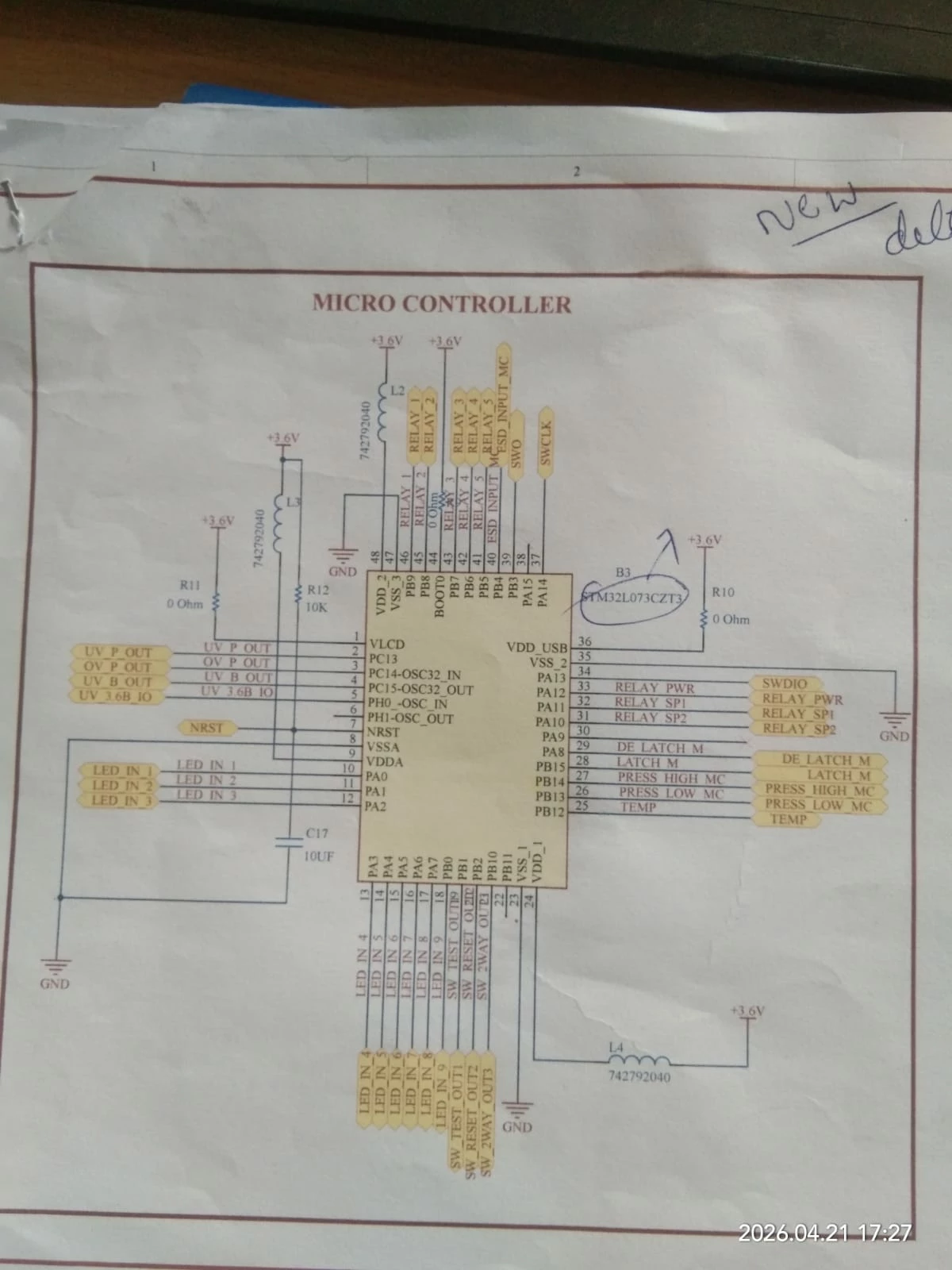

Target No Device Found: SWDIO (PA13) at 0V on STM32L073CZT Custom Board
Hello STM32 Community,
I am facing a persistent "Target no device found" error when trying to program an STM32L073CZT3 custom board using a Nucleo-L073RZ as an external ST-LINK (CN2 jumpers removed).
Hardware Setup:
  • MCU: STM32L073CZT3 (custom PCB)
  • Debugger: ST-LINK V2-1 (Nucleo-64)
  • Connection: 5-wire SWD (SWDIO, SWCLK, GND, NRST, VDD_Sensing)
  • Power: External SMPS providing 3.3V (Common Ground established between SMPS and ST-LINK).
The Issue: While the ST-LINK pins show correct voltages when floating, the SWDIO (PA13) pin drops to 0V the moment it is connected to the target board.
  • Pin 1 (VDD Sense): 3.3V
  • Pin 2 (SWCLK): 3.29V
  • Pin 4 (SWDIO):  (Measured 2.9V on ST-LINK side connection)
  • Pin 5 (NRST): 3.3V
Troubleshooting performed:
  1. Verified continuity; no physical shorts found between PA13 and GND.
  2. Attempted "Connect Under Reset" and "Hardware Reset" at 480 kHz.
  3. Schematic Check: I have a 10uF capacitor (C17) on the NRST line—could this be preventing the debugger from catching the reset state?
  4. Verified that the ST-LINK and the software setup work perfectly on a standard Nucleo-L073RZ board.
I have attached my schematic and a photo of the physical wiring. Does the 0V on SWDIO suggest a software-locked pin or a hardware fault within the MCU?

Mike_ST
Mike_STBest answer
Apr 23, 2026 3:14 PM UTC
Hard to tell with not so detailed pictures.
Check for bridged pins on the STM32.
Check for rotated chip.
On your implementation of the debug connector, I maybe see that you've switched SWCK and SWIO compared to our implementation on the nucleo, please make sure this is not the problem.

Apr 22, 2026 1:05 PM UTC
Is there any mistake in our schematicWhatsApp Image 2026-04-21 at 17.27.43.jpeg

Apr 23, 2026 10:41 AM UTC
  • It is still not working, and I have checked all the connections.
  • Is there any mistake in my schematic?
  • Any issue in power design (VDD / VDDA)?
  • Any problem with SWD or NRST connections?
Mike_ST
Mike_STBest answer
