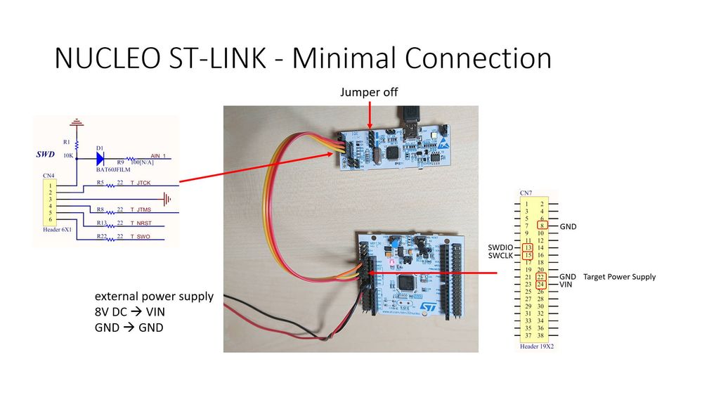

So I'd be very happy to cut my board into two parts. I could power the MCU part with a 3V battery when I only need to run my program. And I could connect the MCU back to the ST-LINK part using jumper cables when I need to flash the microcontroller again. That would be awesome.
But I'm not sure I understand what pin I should connect to what pin to reconnect the ST-LINK to the MCU. I must connect the pin 15 of CN7 to what and the pin 17 of CN7 to what?
I can see the CN4/SWD block on the ST-LINK part of the board but there are 5 pins here, not two. So what do I have to connect to exactly?
KnarfB
KnarfBBest answer
Aug 15, 2020 13:11 UTC
Looks like this:

BCora.1
BCora.1Author
Aug 15, 2020 13:41 UTC
Awesome, that's exactly what I needed, thank you!
But why do they use an external power supply? After the cut it's no longer possible to power the MCU from the USB power that comes from the ST-LINK part?
KnarfB
Aug 15, 2020 14:51 UTC
There are several powering options. I used VIN (7..12 V DC) which gets converted and stabilized on the board.

BCora.1
BCora.1Author
Aug 15, 2020 14:05 UTC
Thanks for the reply!
3.3V would be no problem since that's what I plan to power the MCU with anyway. However, on the figure, they show a 8V DC power supply.
Will it work if I just supply the MCU with 3V (using the MCU's 3V pin) ? Or do I have to supply more voltage and use the 5V pin because there's some stuff in the MCU part that needs the bigger voltage for the ST-LINK to operate correctly?

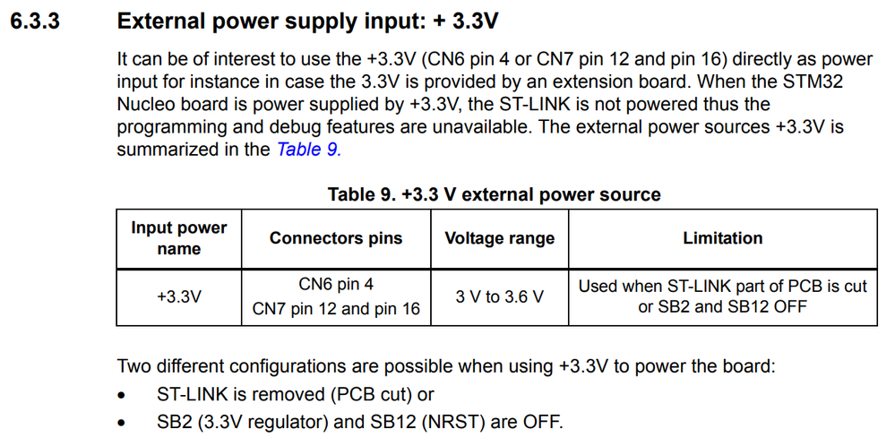

The user manual goes into detail on the different power configurations. They don't suggest supplying 3V directly, but give a similar option:
BCora.1
BCora.1Author
Aug 15, 2020 14:22 UTC
I've read that page of the manual. Don't they just mean that if you power the board only through the +3.3V pin (and not connecting to USB) then the ST-LINK is not powered? At least that's what I understand. But what I plan to do is power the ST-LINK part through USB of course. That's how I plan to flash the chip even after cutting the board: by connecting the ST-LINK part to the computer via USB. Am I misunderstanding something here?

Aug 15, 2020 16:59 UTC
Yes, but now we're talking in circles.
Read "6.3 Power supply and power selection" in the user manual to see the various options for power. There are multiple options to provide flexibility.
The power supply is provided either by the host PC through the USB cable, or by an external source: VIN (7V-12V), E5V (5V) or +3.3V power supply pins on CN6 or CN7.
