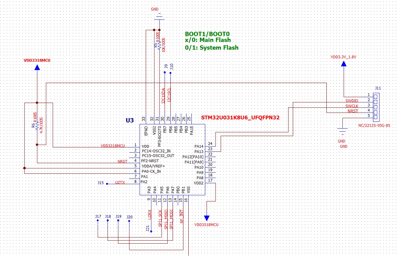

hi~!
I made a IOT prototype with STM32U031K8T6, but I can't download firmware.
The connection isn't working ad it should, can anyone tell me the issues with the attacked circuit ??
I've tried both j-link and st-link download tools.
please reply from users who have used STM32U031.
15 replies

Jun 23, 2025 12:32 PM UTC
The schematic looks okay.

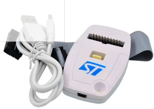

Peter BENSCH
Jun 23, 2025 12:52 PM UTC
...except for the repeatedly inserted R7 (NRESET pull-up), which is not necessary for any STM32 because a pull-up is available internally.
However, R7 is only unnecessary and not the cause of unsuccessful downloads. As @Andrew Neil already mentioned, more information is required for this, e.g. photos of the ST-LINK used, in the case of the ST-LINK/V2 also of the back.
박인구Author
Jun 24, 2025 5:23 AM UTC
Thank you for your answer. I will attach the image of the ST-Link soon.
Jun 23, 2025 1:01 PM UTC
did you have set BOOT0 pin to HIGH before you were trying to download the firmware to MCU?
박인구Author
Jun 24, 2025 5:21 AM UTC
Thank you for your answer. As you can see in the circuit diagram, boot0 is fixed to low.

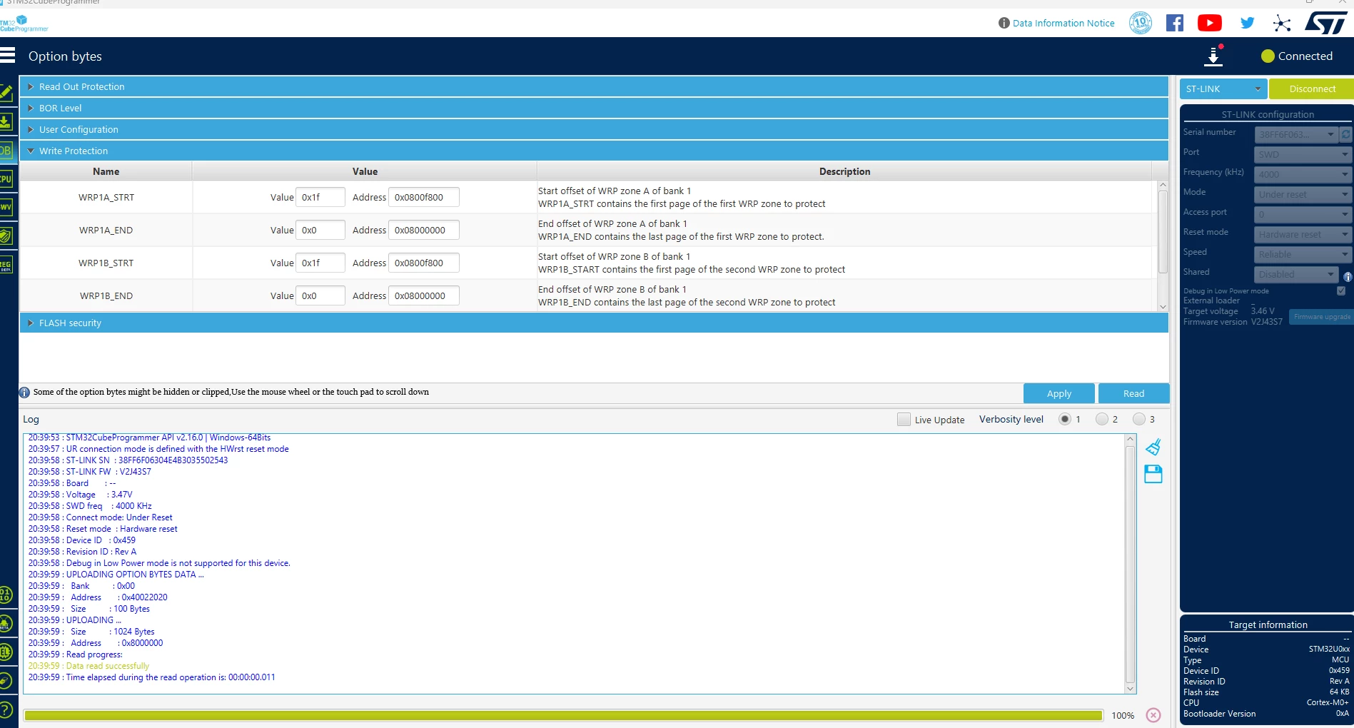

csocom
Sep 25, 2025 11:49 AM UTC
STM32U031K8U6  SWD Download fail
"Write protection is enabled."
"IC purchased from Digi-Key"
"Unable to download after compiling in STM32CubeIDE."
"The connection frequently drops in STM32CubeProgrammer."
SWD 5PIN: +3.3V, SWDIO, SWCLK, NRST, GND
st VLINK V2
"The STM32F469 is working properly using the ST-LINK V2."

Jun 10, 2026 11:26 AM UTC
I suspect your JTAG connect pins are aligned wrong. Should they be 1. 3V3, 2. SWDIO, 3. SWCLK, 4. NRESET, 5. GND  ?
