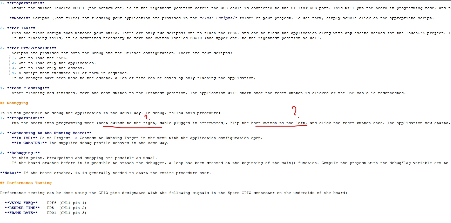

Hello, I have the STM32N6570-DK kit. I can compile, upload and debug by following the instructions on the kit. I designed my own board but I can't debug. I'm reviewing all the possibilities and I noticed some problems. I couldn't find any explanation.

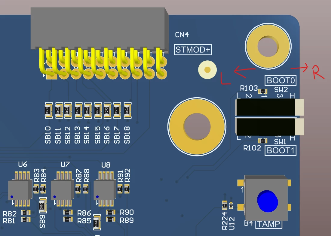

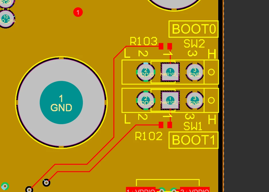

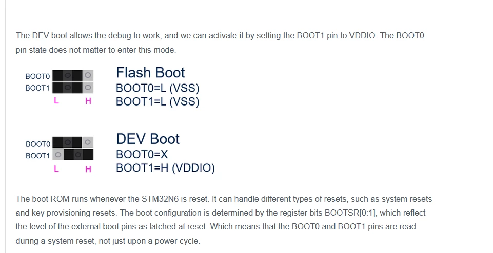

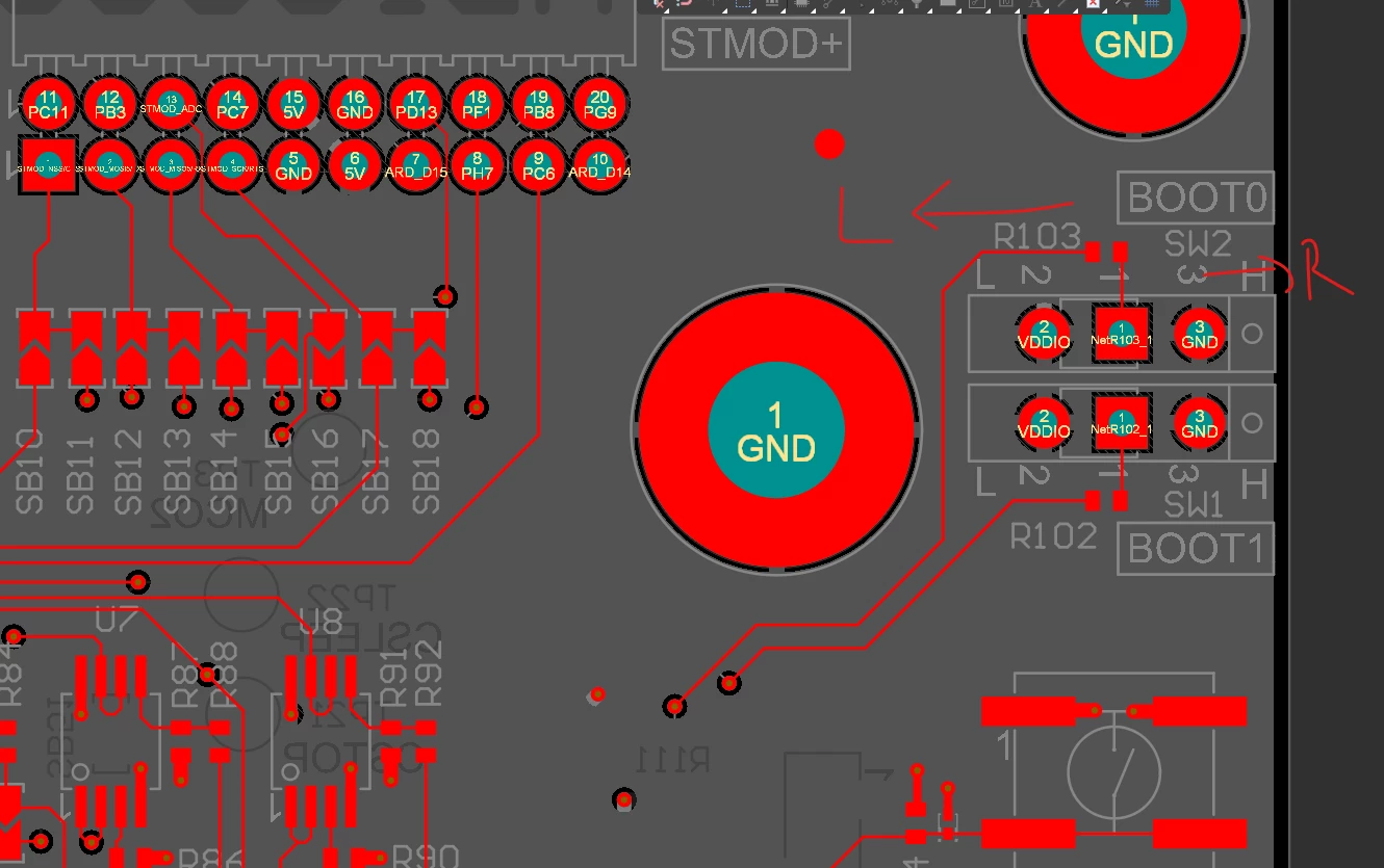

@B.Montanari  's  article says H(High) VDDIO. However, in the DK schematics and pcb, the left side is vddio and the right side is gnd. Also, the Boot1 pin is pulled to the right to load software on the DK. So Boot0 becomes important. What's the problem? Are the documents wrong? Also, on the board I made, I can load software when boot1 is connected to vddio. But on the DK, it allows me to load software when boot1 is GND. What's the explanation?

Hi @Okeskin
This is because on this SPDT DIP switch with common input, the closing direction of the internal contact is reversed compared to the position.
When SW1 or SW2 are in Right position (H), the contact is between 1 & 2. The BOOTn pin = VDDIO.
When SW1 or SW2 are in Left position (L), the contact is between 1 & 3. The BOOTn pin = GND.

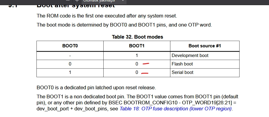

Pins BOOT0 and BOOT1 define the STM32N6 boot sequence.
This is what you shared with Table 32 in RM0486.
Note that BOOT1 has priority over BOOT0.
On your STM32N6570-DK, as explained in the article:
  • When the BOOT1 switch is to the right, it forces pin BOOT1 = VDD = 3.3V.
    This is the DEV_BOOT mode, which allows you to load and debug your code in the internal RAM using SM32CubeIDE or program the external Flash memory and OTP with STM32CubeProgrammer.In DEV_Boot, PG10 (LED2 on the DK) is forced to 0V, and lights up LED2 to indicate that DEV_Boot is active.
  • When the BOOT1 switch is to the left, pin BOOT1 = GND, then BOOT0 define the boot condition, to the left BOOT0 = GND is Flash Boot, and to the right, BOOT0=VDD, is Serial Boot.
There are no errors in the documentation or in the schematics. What are the error message whan you are trying to debug your application?
Share your board diagram or measure the voltage levels you have on BOOT0 and BOOT1 as I explain to confirm is you are applying the correct DEV_Boot conditions.

If you examine the MB1939 project files and the pictures I shared below, you can see that pulling the switches to the right means pulling them to gnd. I can already work on DK without any problems. The problem is that in DK hardware, pulling to the right should be High, but it is actually Low. Please examine MB1939.
