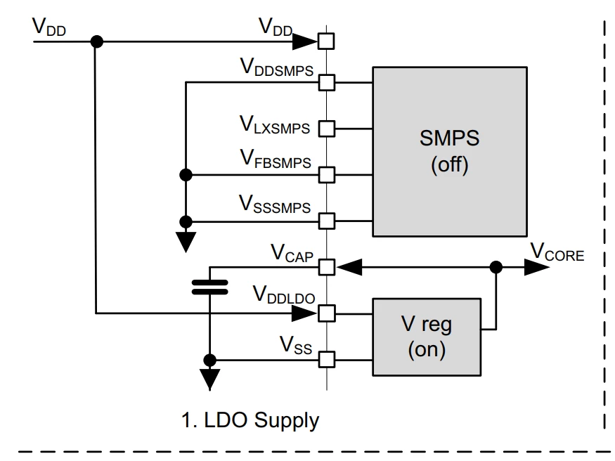

Ok you shared the schematic. Did you take the time to review your schematic according to what was shared above?
It seems you are in LDO configuration, the RM indicates this config:
But in your schematic:
VDDSD and VFBSD are connected to VDD!
So please review the RM and the reference design provided above.

Need first to refer to the AN5307 “Getting started with STM32H7A3/7B3 line and STM32H7B0 Value line microcontroller hardware development” that recommends to refer to the hardware reference designs Nucleo board (NUCLEO-H7A3ZI-Q) in section 8.
Schematic over here.

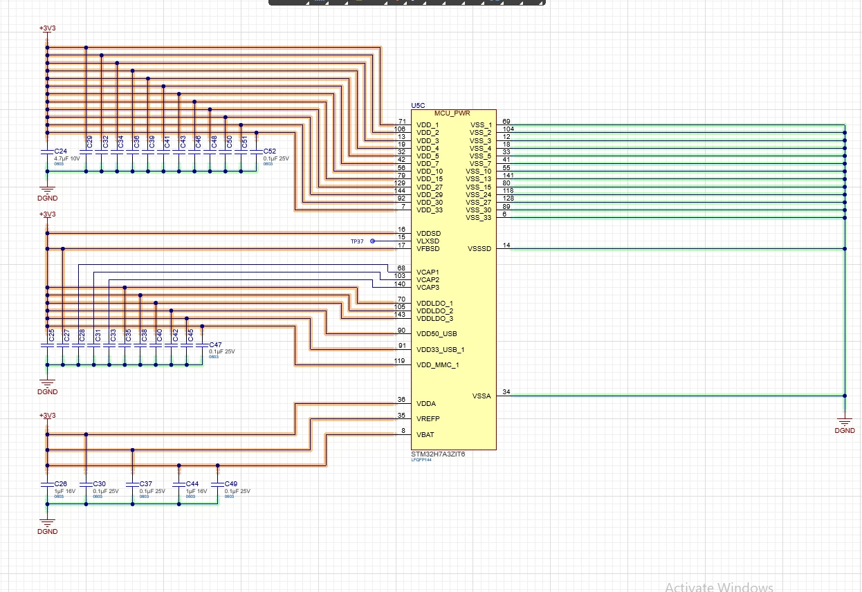

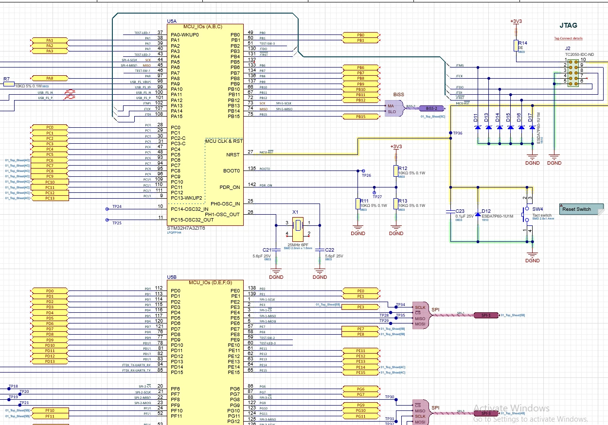

Gowri123Author
Oct 14, 2026 12:13 PM UTC
DIAGRAM OF STM32 AND JTAG
mƎALLEm
mƎALLEmBest answer
Oct 14, 2026 1:09 PM UTC

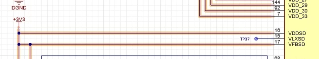

Gowri123Author
Oct 15, 2026 5:49 AM UTC
Thank you for reviewing the schematic and pointing out the issue.
We have reviewed your observations and understand that the connections of VDDSD and VFBSD may not comply with the recommended LDO configuration in the reference manual.
Unfortunately, the PCB has already been fabricated and assembled. Could you please advise whether there is a possible hardware modification or workaround to correct this issue on the existing PCB?
We would also like to confirm whether this configuration could prevent the STM32 from being detected by ST-LINK during programming.
Your guidance would be greatly appreciated.

MM..1
Oct 14, 2026 3:08 PM UTC
In 1.M author write SMPS variant , then i mean plan isnt LDO…
And on schematics is shown JTAG, but normal STLINK V2 dont use JTAG.
Then start with check power stage, and after this is on connect minimum SWD required wires and setup default speed no 100kHz...
