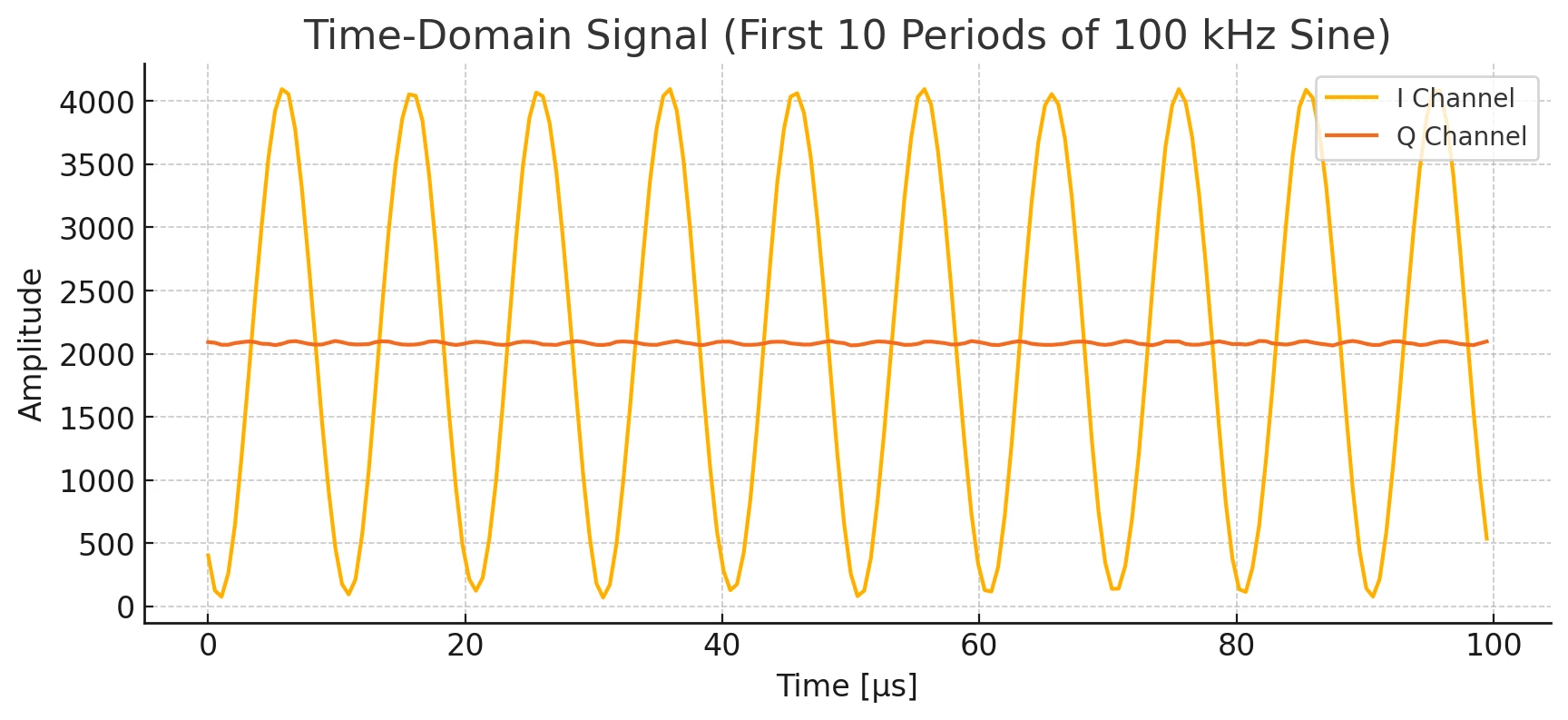

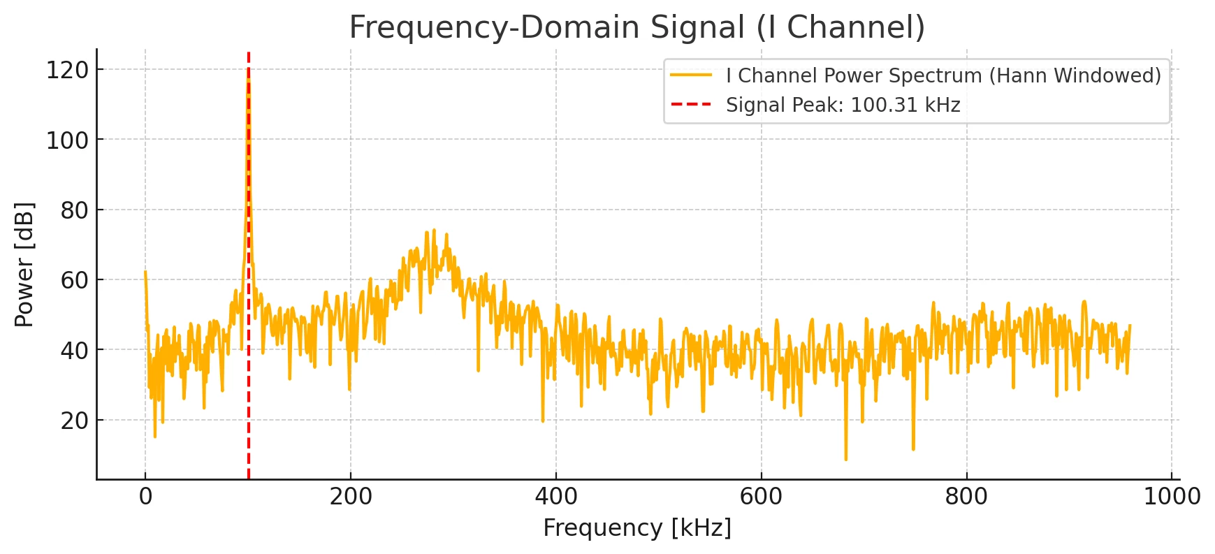

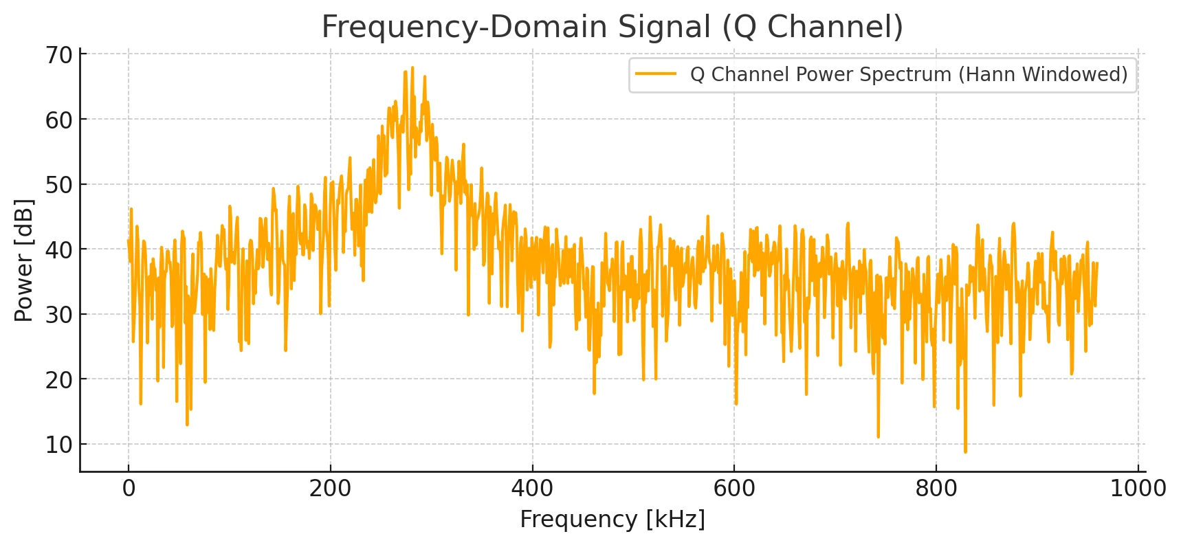

I'm using STM32H755 Nucleo board and I'm evaluating ADC. I'm using 1.92MSPS per ADC sample rate for ADC1 and ADC2. I'm using A0 and A5 pins from CN9. I'm using ethernet to transfer data. My input to A0 (I channel) is 100kHz sine and A5 (Q channel) input is constant 1.6V.
The problem is periodic noise around 320kHz.What might cause that and is it possible to get rid of that? I have read that it might be caused by ethernet connection. I would need ethernet in final application, so would need to solve the issue somehow.

What is the Ethernet reference clock and the frequency?
As mentioned in this ADC value affected by ETH PHY 50 MHz from RMII interface, that  the Ethernet reference clock (ETH_REF_CLK) has been observed to introduce noise into ADC (analog-to-digital converter) measurements.
The issue primarily arises in STM32 microcontrollers where the Ethernet reference clock operates at high frequencies, such as 50 MHz. This high-speed clock can interfere with the ADC's performance, leading to increased noise in the ADC readings.
For that I recommend you to look at this FAQ and check the proposed solution.

My Ethernet reference clock is 50Mhz. Recommended solutions are not ideal. Maybe changing L2 600R@100MHz might improve the situation.

Note that Nucleo boards aren't optimised for analogue performance.
And having an ADC on the same die as loads of high-speed digital stuff is always a compromise anyhow...

I'm not clear for your description. it seems all pictures show the frequency and time domain from input. How do you use the ADC for data converting?
For the 320KHz noise, please double confirm if it's not related to the input 100kHz signals?

I can see this 320kHz noise even though both inputs are connected to ground, so it is unlikely caused by the signal source.

It is recommended to use a clock buffer when using same clock source for STM32 and LAN Phy. However, unfortunately, most of the DISCO boards and nucleos comes without it.
