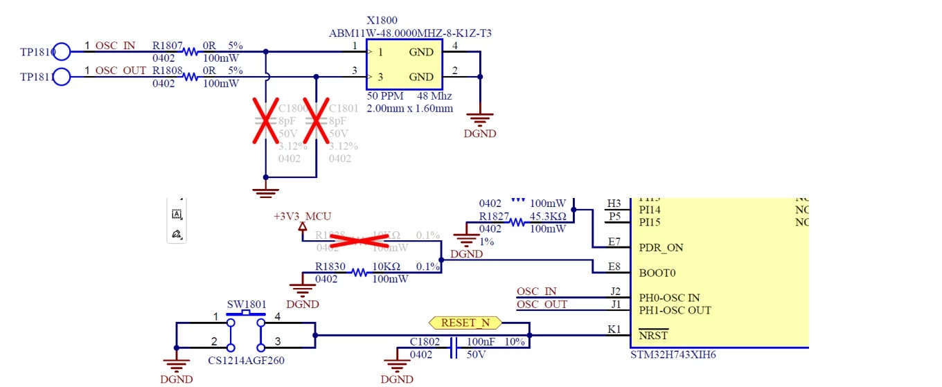

Hi ST Support Team,
I am Using STM32H743XIH6 in one of the project.
Having Query related to crystal frequency.
In datasheet frequency characteristics is provided for oscillator input.
In my Design and STM32H743XIH6 Evaluation Board crystal is implemented.
My Design contains 48Mhz Crystal while EVM contains 25Mhz crystal.

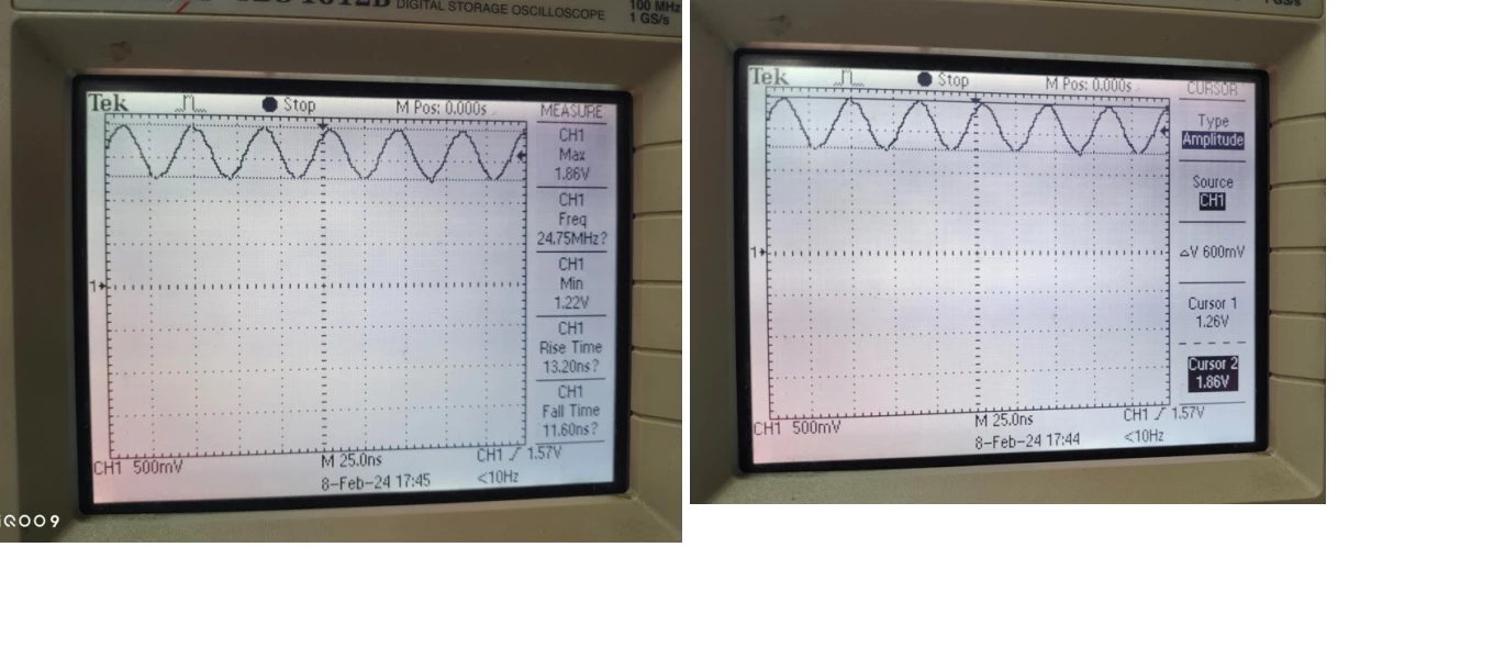

Kindly go through the attached schematic capture of developed board waveform capture at PH0-OSC_IN pin.
Getting same waveform as per Evaluation Kit (Find Attached EVM waveform)
Hope waveform we observed will specify the MCU clock requirement in terms of rise time, fall time, VIH & VIL level.
want to make sure that there is no issue in MCU Clock using external 48 Mhz crystal implementation.
in 25 Mhz & 48 Mhz crystal maximum amplitude is going at 1.8V and MCU operating at 3.3V level.
Hoping that the clock at OSC_PIN is satisfying MCU operating level.

February 8, 2024
Max external crystal frequency is 48 MHz, which yours meets. You should have load capacitors loaded.
The waveform looks fine.
See here for crystal selection design guide:
https://www.st.com/resource/en/application_note/an2867-oscillator-design-guide-for-stm8afals-stm32-mcus-and-mpus-stmicroelectronics.pdf

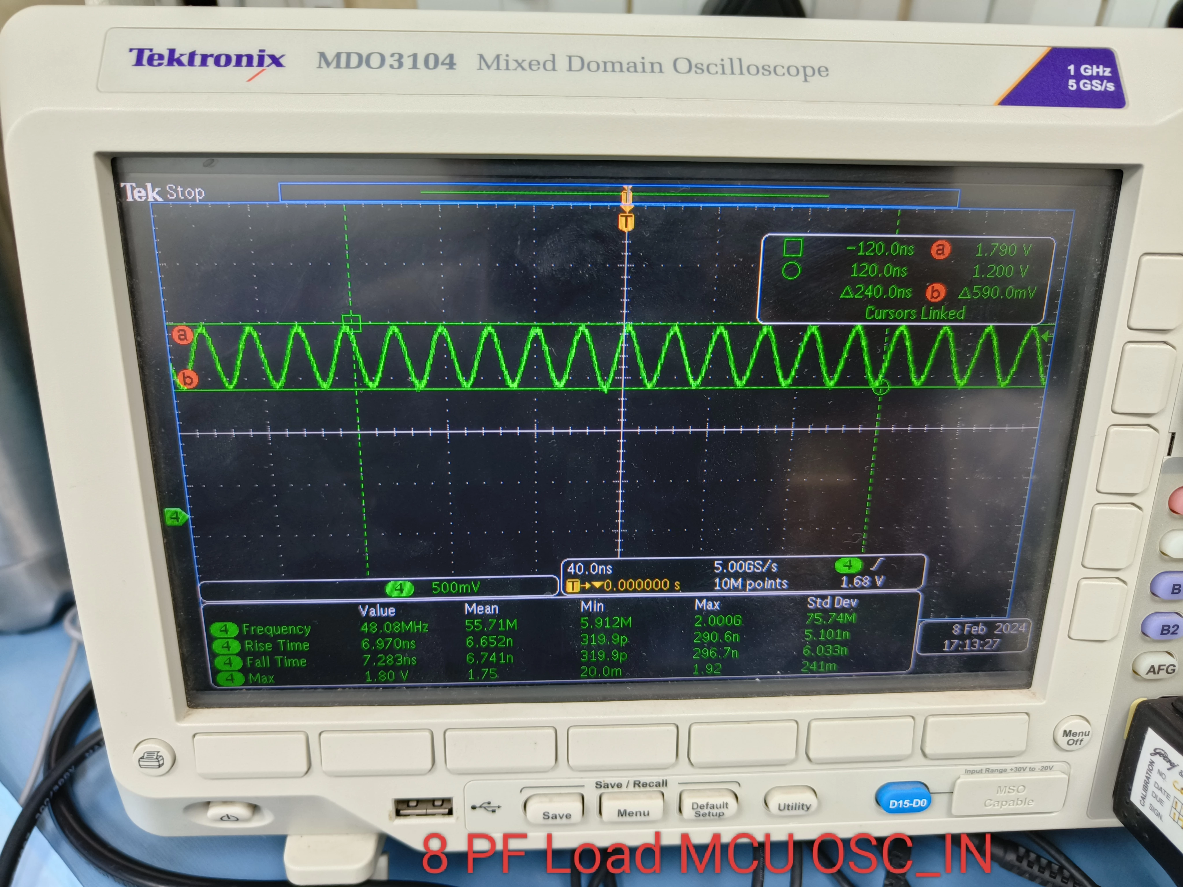

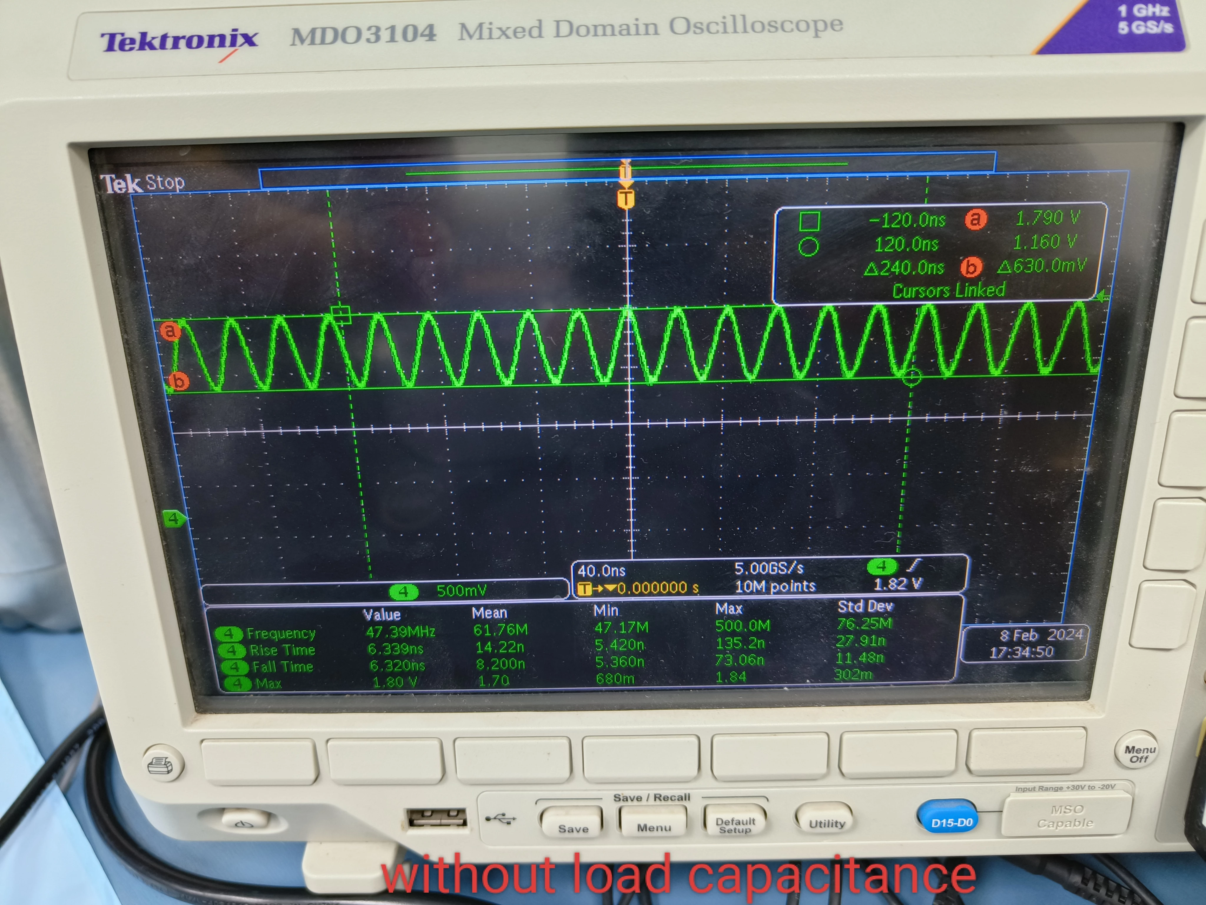

chand_pAuthor
February 8, 2024
Hi TDK,
Crystal having 8 pF load capacitance, added 8 pF capacitor at both pins and getting same result as without load capacitance.
Do need to check with other value of load capacitance?
Attaching snap for your reference.
Thanks..
February 8, 2024
I imagine the capacitance of your scope is distorting things as well.
Just because it works doesn't mean it will continue to do so. Follow the recommendations to have the best chance of success. A little surprised it's working at all without any load caps.
Don't mix up specifications for the external clock input with specifications for the external crystal.

February 8, 2024
Hi
Find attached snap, ignore previous one..
Thanks,

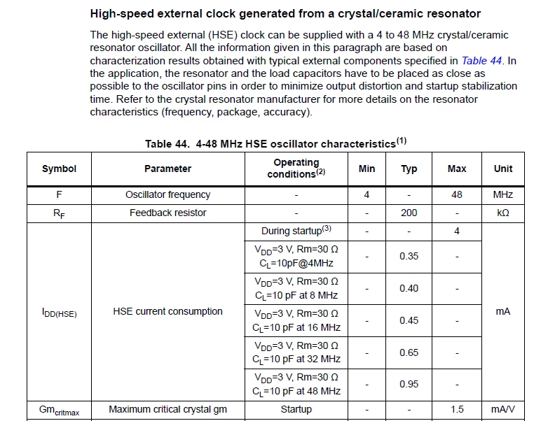

chand_pAuthor
February 9, 2024
Hi TDK,

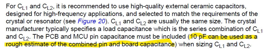

Referring to attached snap considering STM32 10pF load capacitance.
Thanks,
chand_pAuthor

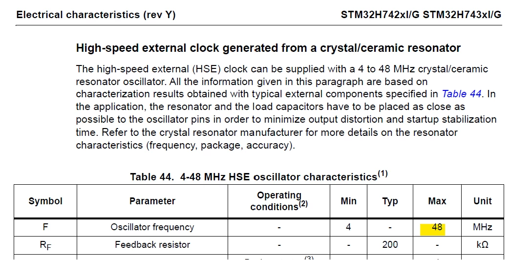

February 9, 2024
Hi TDK,
As per attached snap STM32 Datasheet suggesting to use Oscillator.
As per above table there is no specific requirement related to Vil, Vih level of crystal / oscillator output clock.
Can we go ahead with 48 Mhz Crystal with previous shared waveform results?
we implemented crystal in our design based on EVM 25 Mhz crystal.
If it must to have use an oscillator than what need to do with PH1-OSCOUT pin of STM32?
As in oscillator mainly providing clock output on single pin.
Kindly confirm which external source need to implement..
Thanks..
February 9, 2024
It's up to you. You can use a crystal, or you can use an external clock source.
The 48 MHz crystal you chose will work with the appropriate load caps.
I strongly suspect that the "10 pF" value in the datasheet is misleading. Here is a post by ST to suggest the same:
https://community.st.com/t5/stm32-mcus-products/calculate-external-capacitors-cl1-and-cl2-for-crystal-oscillator/m-p/621261/highlight/true#M230537
Even if it was 10 pF, you should still have load caps of about 6 pF on there. Might want to re-check the math suggested in the guide I linked above.
If you use an external clock source, PH1 doesn't need to be connected to anything.
