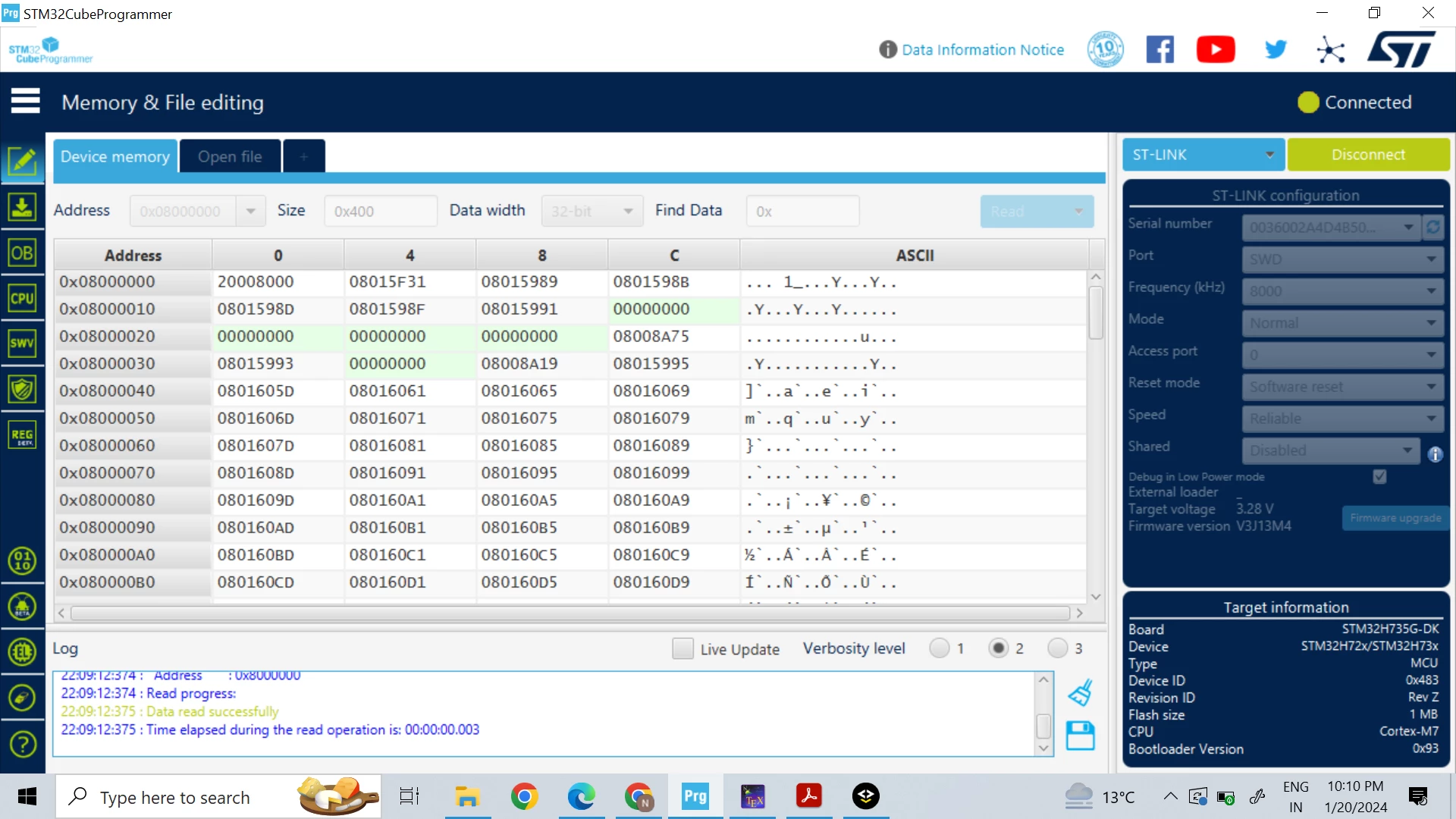

sir,
as suggested i've used STM32cube programmer.
Now the board is connecting to STM32cube programmer. it is reading memeory and other stuff from the board.
i've not erased the memory or programmed it from STM32cube programmer.
But still when i try to program it from IAR workbench, it is unable to program the board.
Tesla DeLorean
Guru
January 20, 2024
Check IAR version and patches for support of H7 parts
STM32Cube_FW_H7_V1.10.0\Utilities\PC_Software\IDEs_Patches\EWARM\EWARMv8_STM32H72x-73x_Support_V0.2.zip
