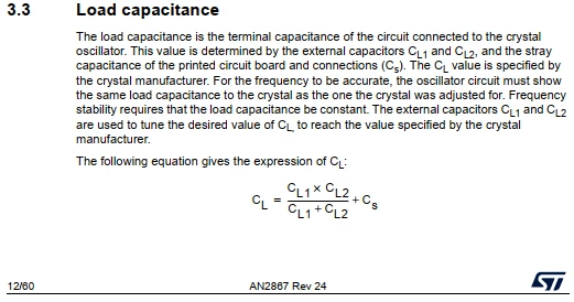

Hello ​@AndyLee and welcome to the ST community,
Because each crystal have its own characteristics and HSE and LSE have different characteristics.
How to select a compatible crystal and load capacitors for STM32 with layout guidelines
AN2867 “Guidelines for oscillator design on STM8AF/AL/S and STM32 MCUs/MPUs”

Jul 24, 2026 2:29 PM UTC
Yes but after confirming the gain margin of the oscillator / compatibility of the crystal with STM32 part number.
Please read How to select a compatible crystal and load capacitors for STM32 with layout guidelines / Sections: 2. Calculation to validate the crystal compatibility with STM32 /  4. Calculation of the external load capacitors value
Hope that helps.

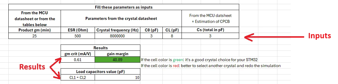

the 24Mhz crystal 6pF, from the equation, should be around 10pF each. But the EVB’s cap is just 6.8pF each. Totally understand the gain and other parameters will lead to adjustment. and that what I trying to understand more.
Can u help on the calculation steps, pls?
The calculation is provided in order in the article.
Example of calculation is provided in 3.1 Example of suitable crystal found after calculation
4. Calculation of the external load capacitors value.
Could you please have a look at these?
PS: download the attached calculator tool excel file STM32-Crystal-Calculator.xlsx and provide the values.

Jul 24, 2026 2:57 PM UTC
Yes, sure and I did.
Just unsure why I have different results when trying to calculate the load capacitors used on STM EVB Nucleo-64 development board with STM32H533RE.
Sorry for the rush and thank you for your reply.
MM..1
MM..1Best answer
Jul 24, 2026 3:54 PM UTC
Simply you require add PCB layout capacity based on layers, material, footprints ...
AndyLeeAuthor
Jul 27, 2026 8:05 AM UTC
Thank you for the comment and it solved my questions.
