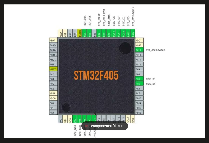

Hello everyone.
I have recently made my own STM32 board based on the STM32F405. After soldering all the components and testing all pads and connections, finding them to be wired correctly and checking that the 3.3V is being supplied to all the correct pins, I tried to upload some code, but to my shock, the STM32F405 isn't establishing a connection via the ST-Link V2 nor the USB cable. After trying multiple fixes, I suspect the issue might be the STM32F405 chip that I got off AliExpress itself.
Before taking any further steps to replace it, I decided to post a question here for review in case the problem was in my PCB design. And sure enough, I had misplaced the chip pin due to the faulty pinout diagram I used as reference.
I have since fixed the chip's orientation and rechecked all pad and pin connections, as well as the 3.3V supply, and found everything to be correct; yet I still cannot get the STM32 CubeProgrammer or IDE to connect with my board using the ST-Link V2 or a USB Type-C.
If you have any remarks on what might have caused this problem, please share them.
NOTE: The -B label is referring to ground, and P is the VCC.
PROBLEM:
BOARD:

Peter BENSCH
Apr 14, 2026 8:11 AM UTC
The serial number of your "ST-LINK/V2" shows only the letter E, so I assume that it is a clone that is not supported (see here).
Regards
/Peter

Peter BENSCH
Apr 23, 2026 7:02 AM UTC
@rayboum Good point: I only now looked at the photo and noticed that you apparently didn’t layout something correctly. The crystal is indeed connected correctly to pins 5 and 6, but at least the JTAG connector is apparently on the wrong pins.
[edit]Sorry, I was too quick, the JTAG looks connected correctly, but lets doublecheck your ST-LINK/V2: please insert a legible photo, front and back.[/edit]

rayboumAuthor
Apr 23, 2026 2:29 PM UTC
Yes, here are the pictures.
I understand that the ST-LINK link I am using is still a cloned one. The one I used previously was completely faulty and didn't even work with the blue or black pill. The red one, on the other hand, belonged to a classmate of mine that used it to regularly program them, so I decided to use it before committing to buying this one, as it is somewhat expensive for a student budget (I still need to buy other components) and it's the only other ST-LINK model currently available in my country.
Now, if you think the red ST-LINK is incapable of programming anything other than the blue and black pill, and the ST-LINK presented in the picture below is my last option, I will buy it. So please understand, before exhausting all my options and making sure that using it will solve the problem, I can't spend what little I have left on it.
Andrew Neil
Andrew NeilBest answer
Apr 23, 2026 2:33 PM UTC
To be sure of getting a genuine ST-Link, buy from an Official Distributor:
https://www.st.com/content/st_com/en/contact-us.html
PS:
It's not that the red clone is incapable - it's that STM32CubeProgrammer and STM32CubeIDE do not support clones.
Peter BENSCH
Apr 23, 2026 2:50 PM UTC
... or use one of the NUCLEO-64 boards, where you can break off the ST-LINK/V2-1 along the perforation, which you can recognise by the long groove. Such NUCLEO boards are generally cheaper than an ST-LINK/V2 - and always genuine (ST-LINK/V2 devices are also counterfeited, as @Andrew Neil wanted to indicate). You can take the cheapest NUCLEO-64 you can find - but make sure it has the ST-LINK/V2-1 and not the non-detachable ST-LINK/V3.
Good luck!
Regards
/Peter
Visitor II
Aug 11, 2026 2:21 AM UTC
Hey still am getting confused with the chip orientation. Is it the correct orientation of the chip o your custom board which you have shown in the image?
Visitor II
Aug 11, 2026 2:32 AM UTC
And what about it? Is it the correct pinout or not? Because I am also facing the same issue with my custom pcb for stm32f405rgt6 having 2 dots on it.
