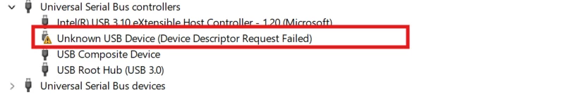

STM32F401RE is not getting recognised in my PC
Hello Team,
I have a new STM32F401RE board along with the ST-Link.
I tried installing all the drivers required for the STM32 hardware, but the USB device itself is not getting recognised. Can you please help me resolve this issue?

Welcome to the forum.
Please see How to write your question to maximize your chances to find a solution for best results
What board, and what ST-Link, exactly ?
Is it a NUCLEO-F401RE board - with the built in ST-Link ?
Some more links on resolving ST-Link connection issues:
How to solve connection errors when connecting and programming the STM32 target board.
How to solve debugger connection issues

Hello @rahul-adhithya and welcome to the ST community,
First, you need to check your USB cable. It should be a data cable and functional. Could you please check that cable with another device and check? or simply use another one.
Second, update your ST-LINK firmware using ST-LINK firmware upgrade tool from this link.
