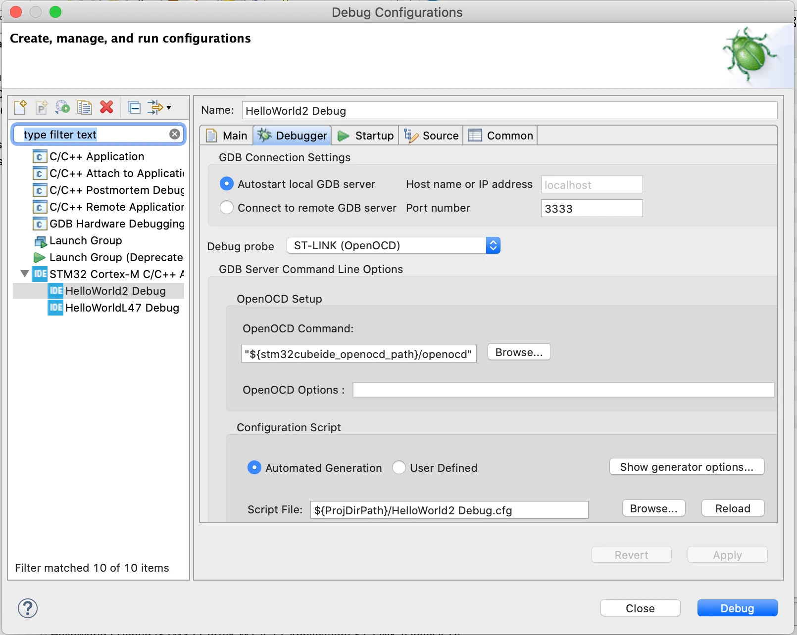

Also take note that in Spaced Cowboy's thread, two individuals was able to switch their IDE to use OpenOCD, so you can use that option as well.
> Hey, I had the same issue and resolved it by setting Debug Configurations -> Debugger -> Debug probe = ST-LINK (OpenOCD)
> I can confirm: changing `ST-LINK (ST-LINK GBD server)` to -> `ST-LINK (OpenOCD)` does work!!!

Found a fix! I am also running the STM32CubeIDE on mac and running into this issue. I remember I had to do some funky thing when installing STM32CubeIDE on OSX Catalina, not sure if that had something to do with the programming not working. From googling around it seems like other users only encounter this problem with Catalina, not previous releases. I really can't believe that ST does no continual testing on their products when new OS's are released. Or if they do, that they are slower than the community fixes here...
The fix is to set the programmer to ST-LINK (OpenOCD) instead of ST-LINK (ST-LINK GDB Server), see screenshot below. The OpenOCD debugger seems to be able to auto-negotiate a speed that works with the debugger.
