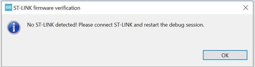

Maybe you can help me, I am not able to start debug session with STLINK-V3MINIE.
Context is: Windows 10 64bit, Intel(R) Core(TM) i5-9400
STMCubeIDE V1.17.0
Tried with 2 different STLINK-V3MINIE
the STLINK-V3MINIE is seen and updated correctly to V3J15M7 using STLinkUpgrade 3.15.7 tool
When trying to open a debug session, I get the message "No ST-LINK detected! Please connect ST-LINK and restart the debug session"
I tried >20 times, connecting on different USB ports, different USB cables, 2 different STLINK-V3MINIE. I tried to switch OFF the firewall.
When I use my old STLINK-V3MINI it is working fine
When I use a Nucleo board, it is working fine
Any idea what I should do? Thanks

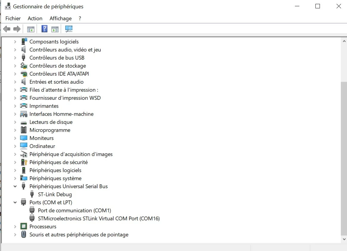

So can Windows itself see the ST-Link? ie, does it appear in Device Manager:
https://community.st.com/t5/stm32-mcus/how-to-solve-debugger-connection-issues/tac-p/698105/highlight/true#M956
Note the PS there specifically for ST-Link V3

In Device manager, it appears as "ST-Link Debug"- driver date 01.04.2021, version 2.2.0.0
and "Virtual COM Port"
It seems there is no error there.

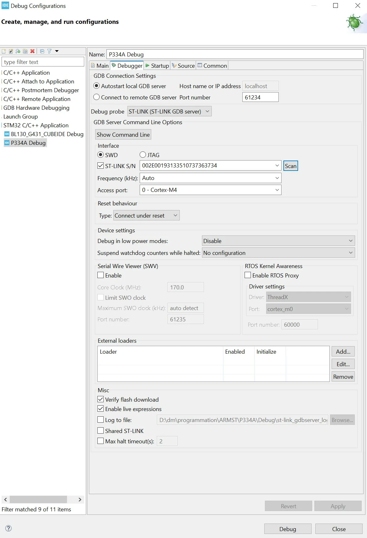

Yes. I think this is not the root cause, because the computer is old (Intel(R) Core(TM) i5-9400) and it is working fine with older STLink such as Nucleo and the old STLINK-V3MINI.
When I open the menu "Run>Debug Configurations" from STM32CubeIDE , tab "Debugger", I can read the debugger S/N (result is 002E00193133510737363734).
I tried with and without USB hub, USB2 and USB3 ports on computer, it's always the same, in device manager it shows the items, in update tool it shows the STLINK-V3MINIE, but debug session always stop with the message "No ST-LINK detected! Please connect ST-LINK and restart the debug session".
Can you explain why the old STLINK-V3 are performing well, but the new STLINK-V3MINIE fail? Is there an important hardware/software difference other than the USB-C socket on the STLINK-V3MINIE and micro-USB on older types?

If it can read the serial number, then CubeIDE can see the ST-Link.
Are you sure you didn't have something else already using the ST-Link (eg, CubeProgrammer) ?
vaucher_bAuthor
January 31, 2025
Yes sure, only Only STM32CubeIDE is open. I checked task manager too, restart computer too. Is it useful to try re-installing CUBE-IDE?

I see the error message, but what is written in the debugger console when you try to debug ?
Maybe there you would get more information.
Another try would be to use the command line, as it is usually more verbose: either gdb server or CubeProgrammer_CLI.
Also, do you really need to specify the S/N in the debug config ? From your device manager you only use one at a time (apparently, I'm only assuming here), so it shall not be mandatory.

Again, if CubeIDE can read the ST-Link's serial number, then it can see the ST-Link - so it should be able to debug.
As @Kraal said, have you tried  to debug without specifying the serial number?
If you specify the wrong serial number, then CubeIDE won't connect - even when it can see the ST-Link.
As @Kraal said, please post the complete console output when you attempt to start a debug session: copy & paste as text rather than a screenshot.
