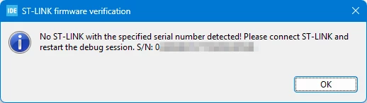

Maybe you can help me, I am not able to start debug session with STLINK-V3MINIE.
Context is: Windows 10 64bit, Intel(R) Core(TM) i5-9400
STMCubeIDE V1.17.0
Tried with 2 different STLINK-V3MINIE
the STLINK-V3MINIE is seen and updated correctly to V3J15M7 using STLinkUpgrade 3.15.7 tool
When trying to open a debug session, I get the message "No ST-LINK detected! Please connect ST-LINK and restart the debug session"
I tried >20 times, connecting on different USB ports, different USB cables, 2 different STLINK-V3MINIE. I tried to switch OFF the firewall.
When I use my old STLINK-V3MINI it is working fine
When I use a Nucleo board, it is working fine
Any idea what I should do? Thanks

Andrew Neil
Jan 31, 2025 3:20 PM UTC
If you get the serial number wrong (or specify a serial number, and that particular ST-Link is not present), you get this error:
Is that what you're getting?

vaucher_bAuthor
Jan 31, 2025 9:15 PM UTC
One last post to follow the topic
I tested on my old AMD computer, Windoes 10, and it is debugging correctly. The driver that Windows has automatically installed for ST-Link Debug (seen in device manager) is different. Driver version 10.0.19041.1 Driver Date 21.06.2006.
The note specific to ST-Link V3 apply to my 2017 computer, but only for STLINK-V3MINIE, not fot other STLINK-V3.
https://community.st.com/t5/stm32-mcus/faq-possible-communication-failure-between-stlink-v3-and-some/tac-p/736830
I hope my difficuties can helo ST team to figure-out the issues with driver and provide a fix or turnaround.
