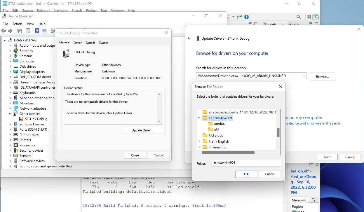

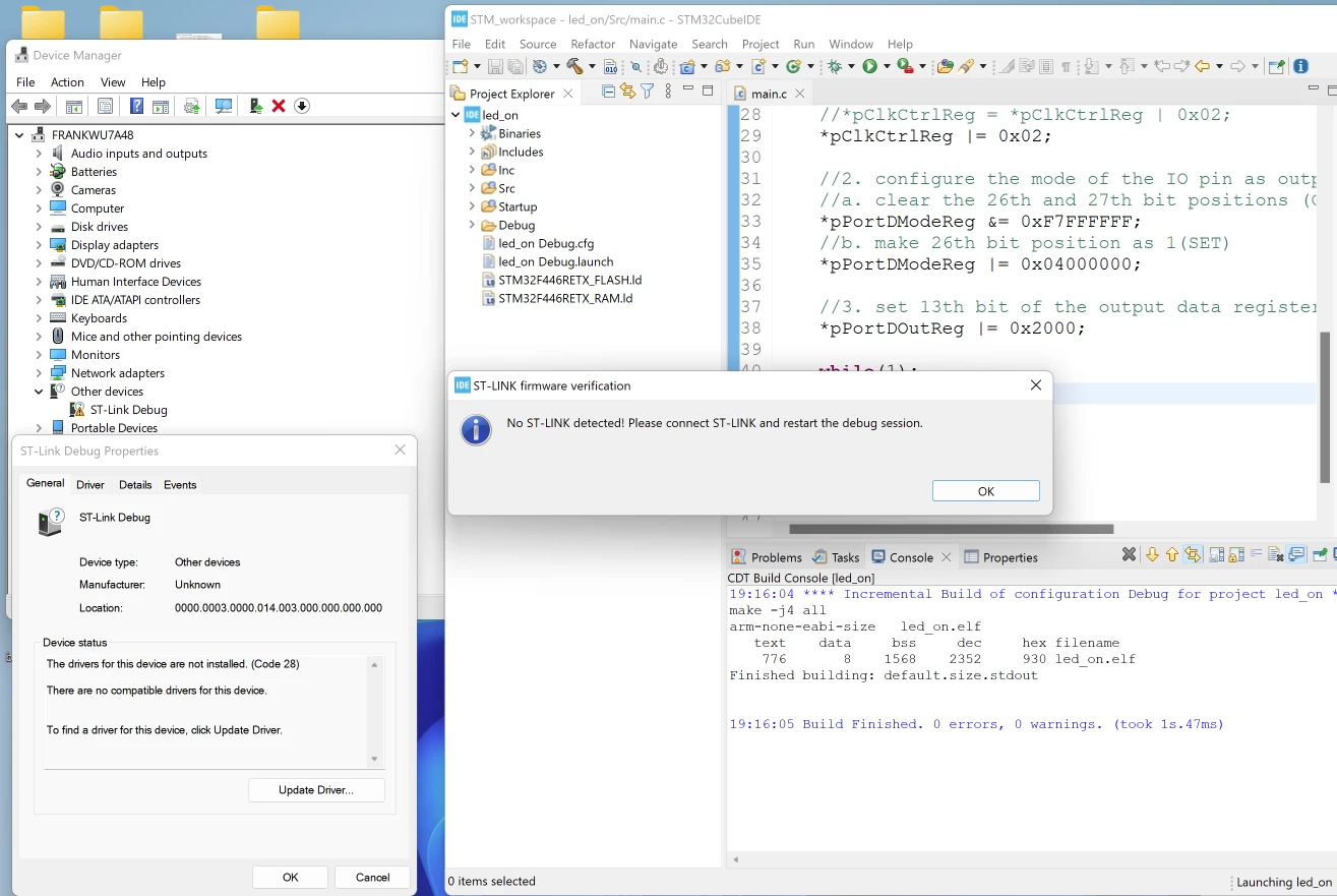

I have tried many ways to solve this question.
Is anything I missed? Please help. Thanks so much!
My OS is windows 11.
7 replies
Tesla DeLorean
Guru
September 18, 2022
Unpack the .ZIP to an actual/real directory
Device Manager,
Update Driver
Specify a directory, that of the amd64 subdirectory as unpacked above
Make sure there's not any AV software or settings blocking driver installation.

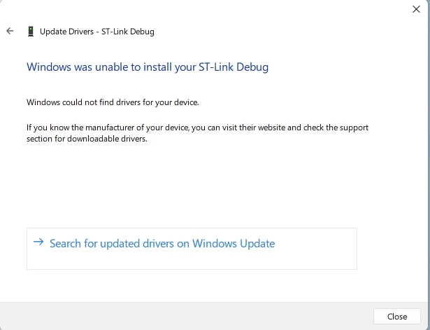

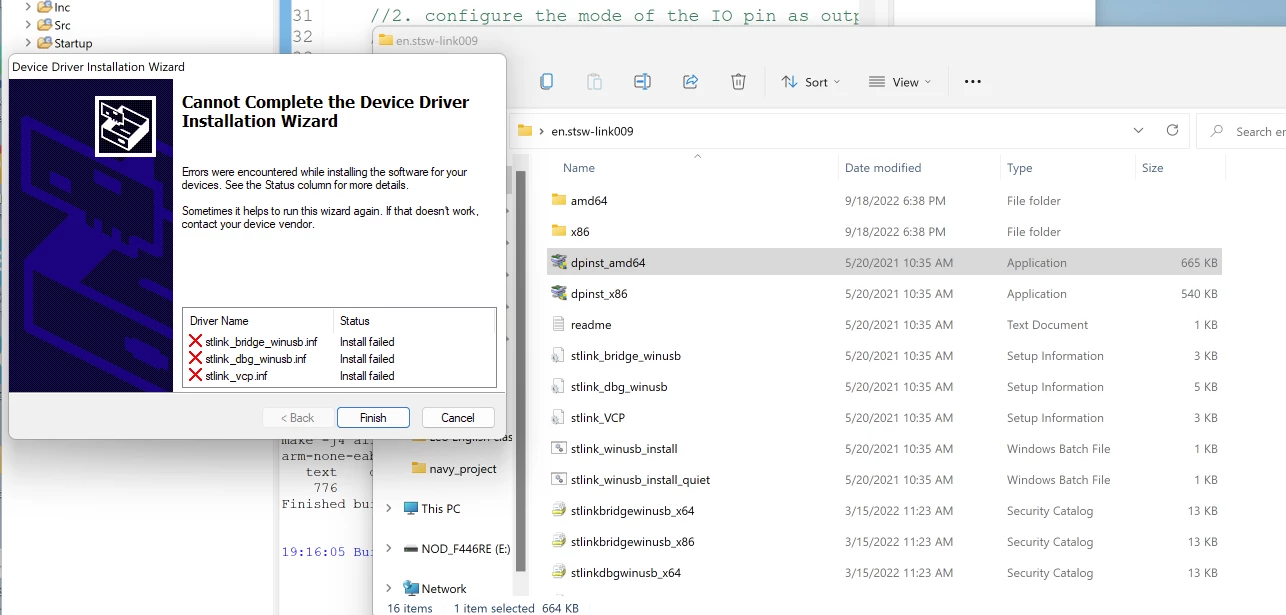

FWu.3
FWu.3Author
September 19, 2022
I did, but it still failed I changed to another laptop and connected correctly. I am thinking about why I could not install it on my laptop.

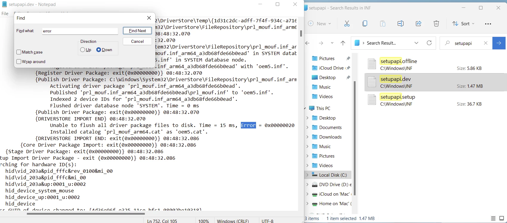

Pavel A.
September 19, 2022
Please find this file on your PC: C:\Windows\INF\setupapi.dev.log
Is there any error related to installation of these drivers?

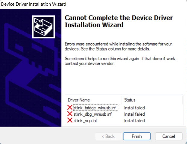

FWu.3
FWu.3Author
September 19, 2022
I have tried solution3(Solution 3: Disabling Enforcement through Startup Settings) from
https://appuals.com/how-to-fix-the-third-party-inf-doesnt-contain-digital-signature-information/
which is the solution from
https://community.st.com/s/question/0D53W00001ONAQySAP/stlink-drivers-unable-to-be-installed-on-windows-11-machine
but still could not solve my issue... and showed me the same thing...
Pavel A.
September 21, 2022
@FWu.3​ The posted log file screenshot does not show anything related to st-link (it is not a mouse). It is not obvious that the problem is caused by wrong signature.
