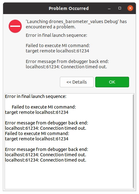

Senior
Jun 3, 2025 8:47 AM UTC
Additional to this there is an another dialog box arises when i debug or run the code. Screenshot from 2025-06-03 16-30-38.png
 what are the reasons this might get

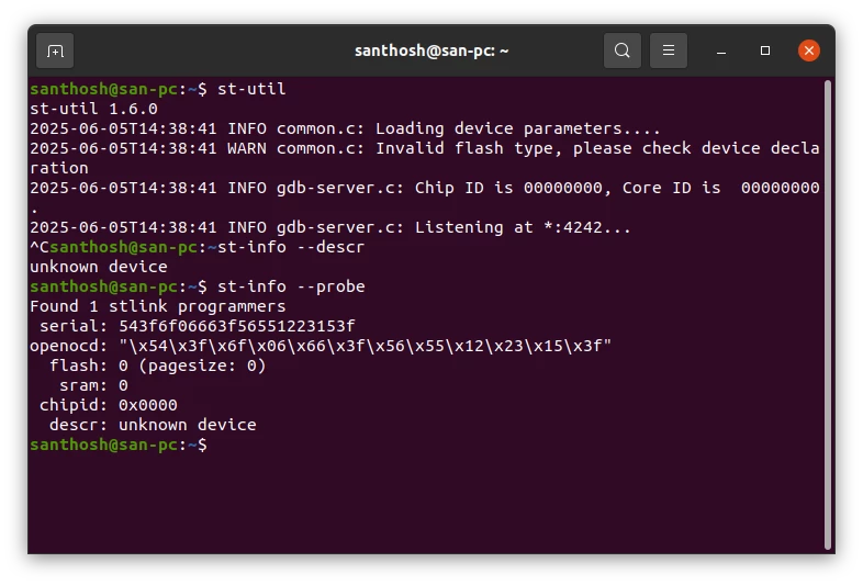

Senior
Jun 5, 2025 8:00 AM UTC
and now i connect it to through stlink commands in linux terminal. shows chip id and core id as 0.
is it due to its not recommended for new designs as they said in their website. https://www.st.com/en/development-tools/stsw-link004.html
