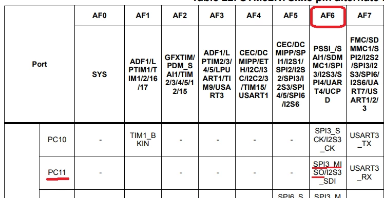

Hi, I have a problem configuring SPI3 on a NUCLEO-H7S3L8 board.
Im writing directly to registers and not using any ready-made functions. I configured SPI3 and everything works correctly as long as I use PB4 as MISO. However, I wanted to use PC11 instead, and then I only read 0xFF.
Im using exactly the same settings for PC11 as for PB4, and both are configured with AF6.
My question is: does PC11 require any special configuration, or maybe something on the Nucleo board blocks it from being used this way?

mƎALLEm
Aug 27, 2026 8:43 AM UTC
Nothing special from NUCLEO board side. PC11 is exposed to both connectors and nothing already connected to it on the board according to its schematic.
What I suggest is to:
1- Start by toggling PC11 and check if it is toggling as intended.
2- Check if you already enabled RCC clock of PC port.
3- Check if you've selected the correct alienate function for SPI3_MISO on PC11. Did you select AF6? (you said you did it but please check):
