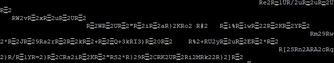

Hi, I have a buffer with 65000 values in 16 bits from the ADC read that I need to provide to my computer running a python code.
Any suggestion how can I handle this in both sides?
I'm trying to use this function but I'm getting weird data when I'm listening the COM port with Putty.
Define "weird".
You're sending raw binary data - so that would not be expected to appear as readable text on a terminal!

Yes, you are right. I will try to catch this with Python to see if I can read the values.

Or you could try RealTerm - it is able to display binary data.

1. The baud rate setting is meaningless for VCP (unless you pass the traffic from/to a real UART) and does not influence the USB transfer speed.
2. Calling the function from main loop will sooner or later freeze the USB stack. The code must be rewritten so that Transmit call is made with interrupts locked or from an ISR of the same priority as USB interrupt.

@fposser wrote:
With this code I was able to read the correct values.
Excellent - please mark the solution:
https://community.st.com/t5/community-guidelines/help-others-to-solve-their-issues/ta-p/575256
That's the PC-side code - yes?
So the STM32 code was working all along - the problem was the PC side interpreting it?
fposserAuthor
October 21, 2024
Yes, this is the PC code.
STM32 was fine.
